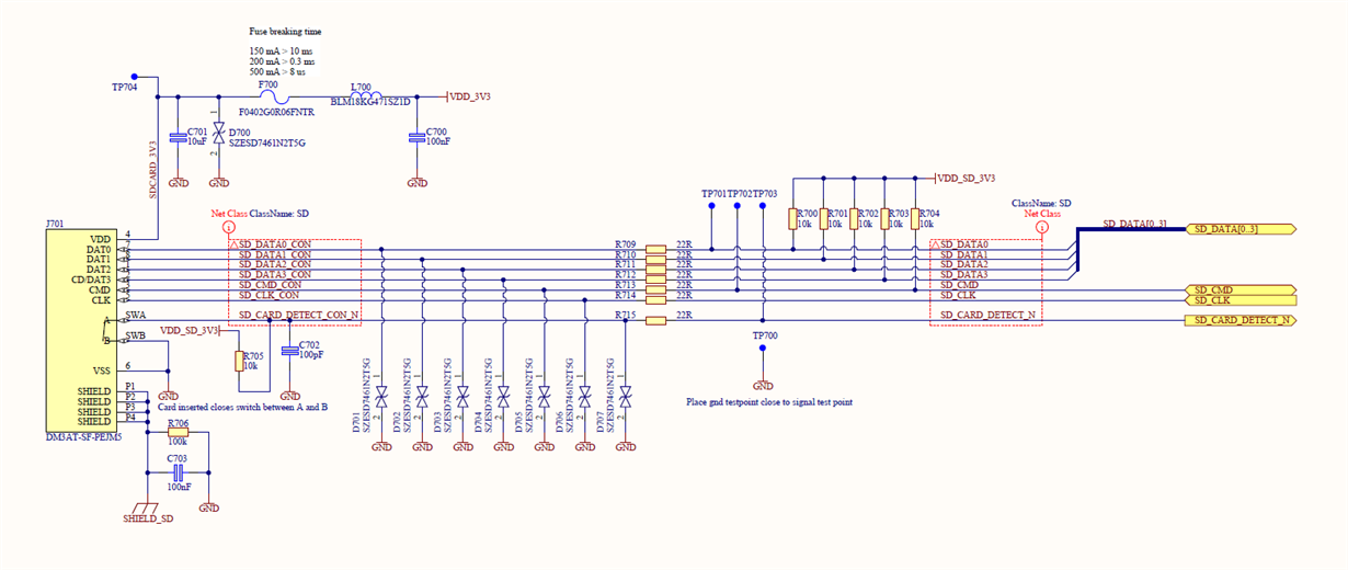

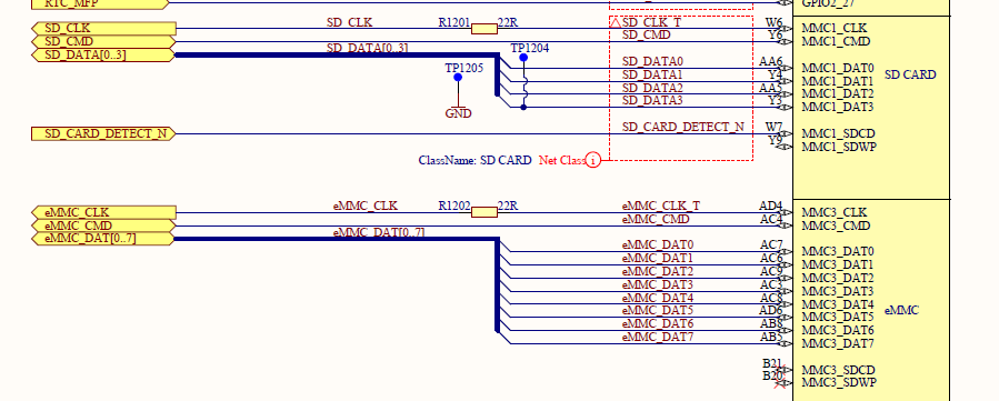

We have  custom board with the am5718
We are using latest u-boot and Linux (linux-4.14.79+gitAUTOINC+e669d52447-ge669d52447) from the Web
(the custom board can not, due to a hardware error, currently talk to the PMIC, but we are not sure if this is neccessarly at the moment)
Problem:
We can not see the SD or eMMC card/chip from Linux  (but form u-boot we can see both)

Our u-boot .dts file look like this
&mmc1 {
	status = "okay";
	pinctrl-names = "default", "sdr12", "sdr25", "sdr50", "ddr50", "sdr104";
	pinctrl-0 = <&mmc1_pins_default>;
	pinctrl-1 = <&mmc1_pins_hs>;
	pinctrl-2 = <&mmc1_pins_sdr12>;
	pinctrl-3 = <&mmc1_pins_sdr25>;
	pinctrl-4 = <&mmc1_pins_sdr50>;
	pinctrl-5 = <&mmc1_pins_ddr50_rev20 &mmc1_iodelay_ddr50_conf>;
	pinctrl-6 = <&mmc1_pins_sdr104 &mmc1_iodelay_sdr104_rev20_conf>;
	bus-width = <4>;
	cd-gpios = <&gpio6 27 GPIO_ACTIVE_LOW>; /* gpio 219 */
	disable-wp;			/* wp not hooked up */
&mmc3 {
	status = "okay";
    pinctrl-names = "default", "sdr12", "sdr25", "sdr50", "ddr50";
    pinctrl-0 = <&mmc3_pins_default>;
    pinctrl-1 = <&mmc3_pins_hs>;
	pinctrl-2 = <&mmc3_pins_sdr12>;
	pinctrl-3 = <&mmc3_pins_sdr25>;
	pinctrl-4 = <&mmc3_pins_sdr50>;
	bus-width = <8>;
	ti,non-removable;
	max-frequency = <96000000>;
	no-1-8-v;
	disable-wp;
	/delete-property/ mmc-hs200-1_8v;

Our schematic look like this
  • Hello Stefan,
    You need to first fix the hardware issue then set-up the i2c PMIC node in the kernel's device tree as you did for U-Boot.
    Kemal
  • Hi
    We found the problem.
    Despite that we have added the 'disable-wp;' as a parameter for the SD/eMMC it turned out that this parameter is ignored in the lower level drivers, the drivers still assume there is write protection pin.
    We added a dummy pin in the pinmux
    {MMC1_SDWP, (M0 | PIN_INPUT_PULLUP | SLEWCONTROL)}, /* Y9 mmc1_sdwp.mmc1_sdwp */
    and replaced the parameter 'disable-wp;' in common.dtsi with
    wp-gpios = <&gpio6 28 GPIO_ACTIVE_LOW>;
    (and the same for MMC23) and now it works
