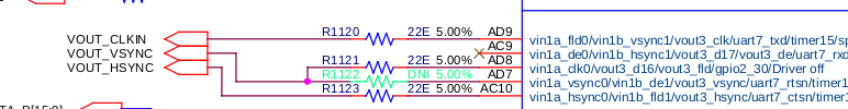

I am working on TDA2PX Custom board, using Vision SDK 3.5. I went through a document DSS BT656 Workaround for TDA2x.pdf for making the ADV7393 encoder work on the custom board.
The CLK_IN,HSYNC ,VSYNC and D0-D15  are input to the encoder. The DAC1  output from ADV7393 is connected to ADA4430 filter. The output from the filter is connected to a fakra connector. We connect the signal from fakra to an Analog output device.

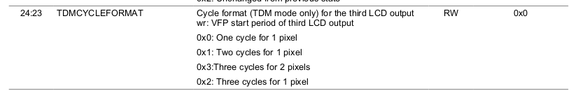

After reading the DSS BT656 Workaround for TDA2x.pdf I added TDM configuration.
DISPC_CONTROL1.TDMENABLE = 0x1: TDM enabled
DISPC_CONTROL1.TDMPARALLELMODE = 0x3: 16-bit parallel output selected
DISPC_CONTROL1.TDMCYCLEFORMAT = 0x1: 2 cycles for 1 pixel
DISPC_DATA1_CYCLE1 = 16
DISPC_DATA1_CYCLE2 = 0
DISPC_DATA1_CYCLE3 = 0
But with the changes for TDM mode resulted in ON/OFF of the display along with flickering. So I removed them again.

  • Deepika,
    Set one cycle per pixel in the TDM mode.
    Also make sure that the mode-1 is used in ADV.. This is the only mode where it can be supported.

    As mentioned in the DSS BT656 Workaround for TDA2x , instead of connecting VSYNC we need to connect FLD signal to the ADV. Right now, I am not getting any clock on the FLD line, but I am getting signal on Vsync. From Pin mux point of view , VIN1A_CLK0 pad is used for generating VOUT3_FLD. The mux mode value for this pin is coming 4. This means FLD is configured.
    Is there any other configuration in DSS to enable the FLD signal?

  • Hi Brijesh,
    Can you please help me in getting VOUT3_FLD SIGNAL?
    Pin mux value shows correct mux-mode.
    Deepika
  • Hi Deepika,
    Clock does not come out of FLD pin, it will be field id signal, which comes out of FLD pin. This pin is used only for interlaced output mode, so are you setting interlaced mode, ie NTSC or PAL??

  • Hi Brijesh,
    Actually by going through the DSS BT656 Workaround for TDA2x.pdf document, our hardware design has been changed. Instead of connecting the vsync signal from the SoC to the encoder, they have connected the FLD signal to the encoder.
    So I am not able to understand what type of output will come from the FLD signal,

  • Hi Deepika,
    It seems driver does not support NTSC perse, but it support 480I, can you try setting FVID2_STD_480I mode?
    In addition, you need to enable TDM mode for 16bit output mode and set the data over two pixel clock clock with entire 16bit in first clock cycles and second clock cycle just duplicates the value.
    I am not sure if there is any driver config for the same, if not, can you check the register where we enable TDM mode and change the config directly?

  • Hi Brijesh,
    Thanks for your reply. I will try setting  FVID2_STD_480I  and let you know.
    I am now trying to write DISPC_CONTROL3  (0x58001848)  directly.
    "In addition, you need to enable TDM mode for 16bit output mode and set the data over two pixel clock clock with entire 16bit in first clock cycles and second clock cycle just duplicates the value. "
    Yes..this I read in the DSS workaround document for ADV7393. So according to this  TDMCYCLEFORMAT bit from DISPC_CONTROL3 should be set to 0x1 (Two cycles for 1 pixel)
    Can you please check if this is is OK?
    Deepika
  • Deepika,
    Yes, TDM CYCLE Format should be set to Two cycles for 1 pixel. and then, configure to send out all 16bits on first clock cycle and second clock cycles just repeats data value.

    3)  In displayCtrlLink_drv.c  file
            Vps_DssDispcAdvLcdTdmConfig advTdmPrms;
                VpsDssDispcAdvLcdTdmConfig_init(&advTdmPrms);
                advTdmPrms.tdmEnable = TRUE;
                advTdmPrms.tdmCycleFormat = 0x1;
                advTdmPrms.tdmParallelMode = 0x3;
                advTdmPrms.noBitsPixel1Cycle1 = 16;
                advTdmPrms.noBitsPixel2Cycle1 = 0;
