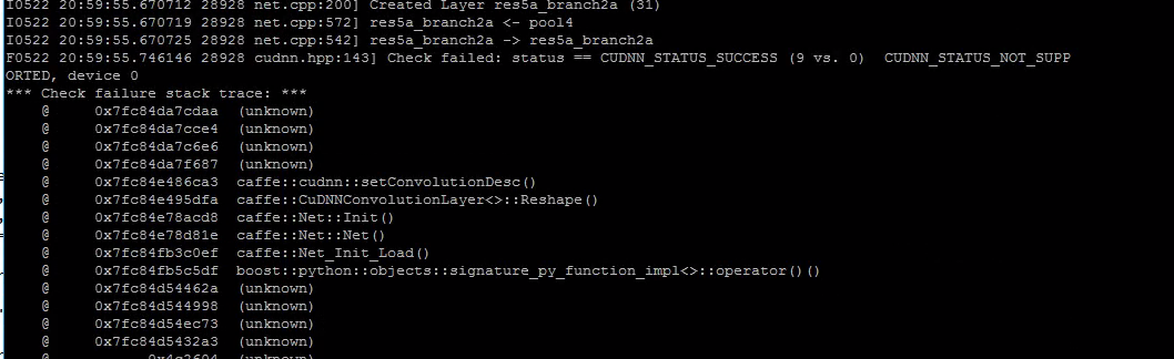

    I have followed the document to complete dataset preparation.
    But, I meet the error when training/infering jsegnet:
    I have trained/infered jdnet/resnet/mobilenet successfully. So, I don't understand why this happened.
    How do I solve this problem?

  • Hi, I am not able to exactly understand your scenario. Have you done one round of training exactly as given in the documentation (with only 2048x1024 images in the folder). Other have used this training procedure - so I don't see a reason for it to fail.
    1.I have followed the documentation to finish data preparation(with only 2048x1024 images ).
    2. When I execute training, program stops at "Createing Layer res5a_branch2a" :
    Check failed: status == CUDNN_STATUS_SUCCESS(9 vs. 0) CUDNN_STATUS_NOT_SUPPORTED
    So, I just run infer.sh with deploy.proto and given caffemodel, that problem still exists.
    Though I have trained JDNET/Resnet/Mobilenet on caffe-jacinto.
    Now, I think it may be caused by my CUDA/CUDNN version:
    CUDA Version 8.0.61
    CUDNN Version 6.0.21
    Do theose versions match for Jacinto?
  • You may want to try after updating to cudnn7.
    Also, can can attach the full log file? (Did you attach it? I couldn't find it)

    F0527 15:54:44.706336  3047 cudnn.hpp:143] Check failed: status == CUDNN_STATUS_SUCCESS (9 vs. 0)  CUDNN_STATUS_NOT_SUPPORTED, device 0
    *** Check failure stack trace: ***

    Namespace(batch_size=1, blend=2, class_dict='', crop=['0'], input='test_img/test-img-list.txt', label=None, label_dict='', model='deploy.prototxt', num_classes=None, num_images=2, output='test_img/out', palette='[[0,0,0],[128,64,128],[220,20,60],[250,170,30],[0,0,142],[0,0,0],[0,0,0],[0,0,0],[0,0,0],[0,0,0],[0,0,0],[0,0,0],[0,0,0],[0,0,0],[0,0,0],[0,0,0],[0,0,0],[0,0,0],[0,0,0]]', resize=['1024', '512'], resize_back=True, resize_op_to_ip_size=False, search='*.png', weights='cityscapes5_jsegnet21v2_iter_120000.caffemodel')
    Creating palette
    test_img/out
    path test_img/out exists
    ./infer_cityscapes_segmentation.sh: line 34:  3047 Aborted                 (core dumped) ./infer_segmentation.py --crop $crop --resize $resize --model $model --weights $weights --input $input --output $output --num_images $num_images --resize_back --blend 2 --palette="$palette5"
         Now, the problem solved:
         1. keep only the original images and labels to make lmdb
         2. update cudnn.so and rename it as cudnn.so.5 in /usr/local/lib/
         I can train/infer JSegNet well now.
         Thanks for you help!
  • Glad to know that it is working. I have two questions:
    1. Which branch of caffe-jacinto are you using? is it caffe-0.17
    2. Which version of cudnn worked for you?
  • 1.caffe-jacinto-0.17
    2.cuda - 8.0.61 , cudnn - 6.0.21
