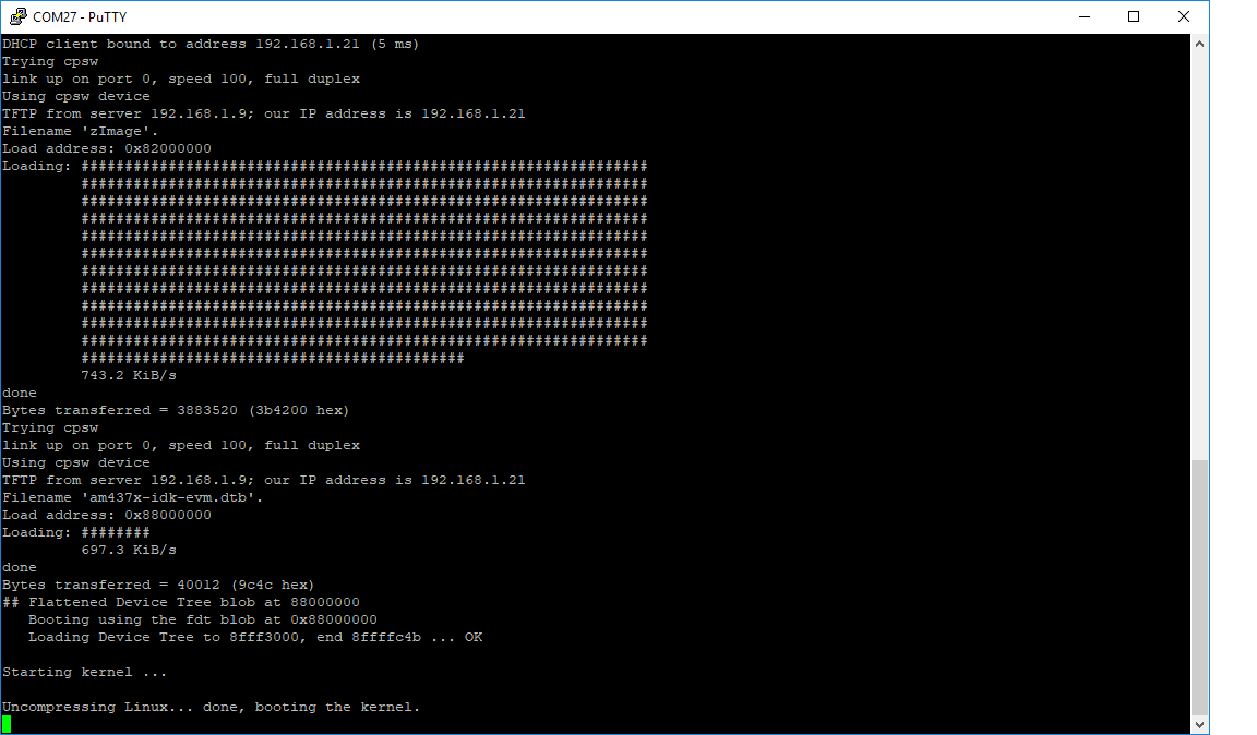

3) Booting zImage on our Target SOC u-boot loads zImage to RAM but not debug messages are output, here is the console output of the startup from u-boot on the target:
U-Boot SPL 2018.01-00558-g8617e02-dirty (Jul 26 2019 - 15:03:35)
Trying to boot from eth device
** No partition table - mmc 0 **
Using default environment
<ethaddr> not set. Validating first E-fuse MAC
<ethaddr> set to CoreACE CPU A
CoreACE eth_env_set_enetaddr()
cpsw, usb_ether
Error: usb_ether address not set.
Trying cpsw
cpsw Waiting for PHY auto negotiation to complete.... done
link up on port 0, speed 100, half duplex
BOOTP broadcast 1
BOOTP broadcast 2
BOOTP broadcast 3
DHCP client bound to address 192.168.1.21 (1058 ms)
Using cpsw device
TFTP from server 192.168.1.9; our IP address is 192.168.1.21
Filename 'u-boot.img'.
Load address: 0x82000000
Loading: #################################################################
727.5 KiB/s
done
Bytes transferred = 611400 (95448 hex)
U-Boot 2018.01-00558-g8617e02-dirty (Jul 26 2019 - 15:03:35 -0400)
CPU : AM437X-GP rev 1.2
Model: TI AM437x CoreACE Rev 0.00
DRAM: 1 GiB
Can't find PMIC:TPS62362
NAND: 0 MiB
MMC: OMAP SD/MMC: 0
MMC: no card present
** Bad device mmc 0 **
Net: <ethaddr> not set. Validating first E-fuse MAC
cpsw, usb_ether
Hit any key to stop autoboot: 0
Booting from network ...
Trying cpsw
cpsw Waiting for PHY auto negotiation to complete. done
BOOTP broadcast 1
DHCP client bound to address 192.168.1.21 (6 ms)
Trying cpsw
link up on port 0, speed 100, full duplex
Using cpsw device
Filename 'zImage'.
724.6 KiB/s
done
Bytes transferred = 3883520 (3b4200 hex)
Trying cpsw
Using cpsw device
Filename 'am437x-idk-evm.dtb'.
Load address: 0x88000000
Loading: ##########
705.1 KiB/s
done
Bytes transferred = 46974 (b77e hex)
## Flattened Device Tree blob at 88000000
Booting using the fdt blob at 0x88000000
Loading Device Tree to 8fff1000, end 8ffff77d ... OK
Starting kernel ... <============= Last message printed by U-boot
<============= Target board does not get to start_kernel()?????
I think our target is having issue at a much lower point in the boot process than main.c, perhaps in Init.S or at the _start vector?  I do have an XDS560 emulator connected to the target using CCS, when I am connected to the CortexA9 and pause debugging I stop in the address range 0xC01023C0, but I have not been able to load symbols for zImage to see what function/tag this is in the source?  Perhaps, help with loading symbols may reveal more details?
Also, it is not clear what could be different from the EVM to the our Target? The EVM uses an AM4379 while our target is AM4376. The devicetree for the am437x-idk-evem is referencing targets in the AM437x and AM4372 family so I am not sure is need to make an update there?
Any direction you can give in debugging this boot issue is most welcome, I continue to look for samples on what to debug before Linux enters main.c and have not found anything yet.
Thanks in advance,
Rob
  • Rob,
    When we see things fail at Starting Kernel it is usually related to DT. Can you try to disable some of your less critical interfaces in your DT and see if you can get different results? We usually recommend starting with kind of a bare DT and adding things in iteratively.
    Hopefully this is helpful to you.
  • I removed devices form the DT until it looked like this:
    * Copyright (C) 2014 Texas Instruments Incorporated - http://www.ti.com/
    * This program is free software; you can redistribute it and/or modify
    * it under the terms of the GNU General Public License version 2 as
    * published by the Free Software Foundation.
    /dts-v1/;
    #include "am4372.dtsi"
    #include <dt-bindings/pinctrl/am43xx.h>
    #include <dt-bindings/pwm/pwm.h>
    #include <dt-bindings/gpio/gpio.h>
    #include <dt-bindings/input/input.h>
    model = "TI AM437x Industrial Development Kit";
    compatible = "ti,am437x-idk-evm","ti,am4372","ti,am43";
    chosen {
    stdout-path = &uart0;
    aliases {
    Our target still does not boot?
    Are there additional devices in the AM4372.dtsi that may be at issue?  Or have I removed too much from the am437x-idk-evm.dts file?

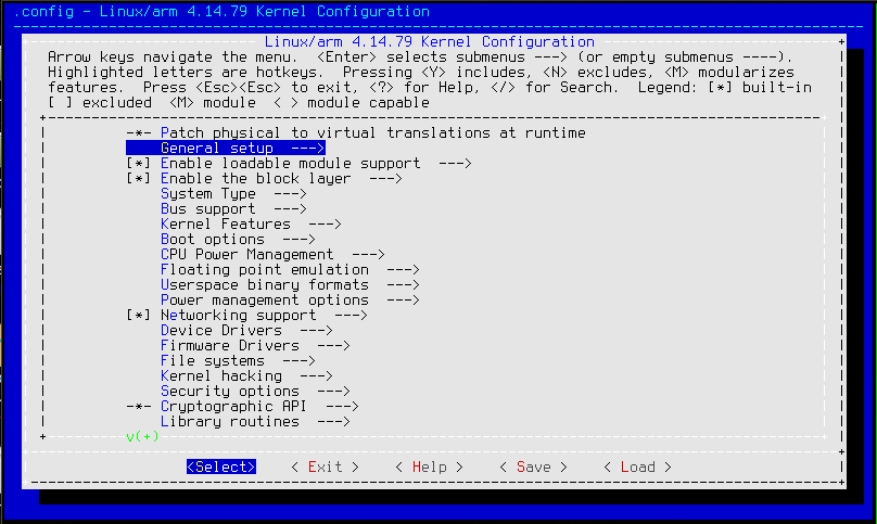

  • In trying to debug this issue further I found this link:
    http://processors.wiki.ti.com/index.php/Kernel_-_Common_Problems_Booting_Linux#Problem_.231_-_No_more_output_is_seen_on_the_console_after_.22Starting_Kernel....22
    I updated the .config to turn on "Kernel hacking" and now I get this message when I run on my target.
    It appears that the kernel is actually running on the target and uncompressing zImage successfully.  The link indicates that there are 2 possible sources of error at this point:
    1) Cause #2 B - Mis-match between device tree blob and the actual hardware
    I have spent quite a bit of time debugging the devicetree and have found the root cause.
    2) Cause #2 A - Mis-match between boot-loader and kernel machine numbers
    Is it possible that the AM4379 used on the am437x-idk-evm and the AM4376 have different machine IDs? Do I need to rebuild zImage for the correct ID?
    Thanks in advance,
    Rob

    U-Boot 2018.01-00558-g8617e02-dirty (Jul 30 2019 - 12:08:03 -0400)
    DRAM: 1 GiB
    NAND: 0 MiB
    MMC: OMAP SD/MMC: 0
    cpsw, usb_ether
    Trying cpsw
    BOOTP broadcast 1
    Trying cpsw
    Using cpsw device
    Filename 'zImage'.
    722.7 KiB/s
    done
    Bytes transferred = 3453440 (34b200 hex)
    Trying cpsw
    Using cpsw device
    Filename 'CoreACE_C.dtb'.
    Loading: #########
    627 KiB/s
    done
    Bytes transferred = 43678 (aa9e hex)
    Loading Device Tree to 8fff2000, end 8ffffa9d ... OK
    Starting kernel ...

    2. Open menuconfig:
    1. make ARCH=arm CROSS_COMPILE=/home/sitara/ti-processor-sdk-linux-am335x-evm-05.03.00.07/linux-devkit/sysroots/x86_64-arago-linux/usr/bin/arm-linux-gnueabihf- menuconfig

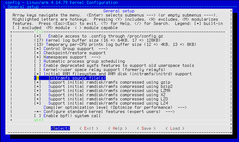

    • You should see something like below. Select "General setup" as indicated below:
    • You should now be able to scroll down to
    • You once again use enter to go into this and choose the folder where you extracted the files:
    • You can now save the changes and exit out of menuconfig.

  • Ron,
    I will attached the wireshark capture to another reply on this link.
    Here is the Terminal listing of the EVM booting on my system using netboot:
    BTW: I ran the ethtool utility that was included in the rootfs with zImage.
    U-Boot SPL 2018.01-00558-g8617e02-dirty (Jul 26 2019 - 14:56:16)
    Card did not respond to voltage select!
    cpsw, usb_ether
    Trying cpsw
    BOOTP broadcast 1
    DHCP client bound to address 192.168.1.21 (4 ms)
    Trying cpsw
    Using cpsw device
    Filename 'zImage'.
    757.8 KiB/s
    done
    Bytes transferred = 10854912 (a5a200 hex)
    Trying cpsw
    Using cpsw device
    Loading: ##########
    804.7 KiB/s
    done
    Starting kernel ...

    Booting from network C...
    BOOTP broadcast 1
    DHCP client bound to address 192.168.1.33 (4 ms)
    Using cpsw device
    TFTP from server 192.168.1.9; our IP address is 192.168.1.33
    Filename 'zImage'.
    549.8 KiB/s
    done
    Using cpsw device
    Loading: #########
    603.5 KiB/s
    done
    Bytes transferred = 43322 (a93a hex)
    Loading Device Tree to 8fff2000, end 8ffff939 ... OK
    Starting kernel ...

    U-Boot 2018.01-00558-g8617e02-dirty (Aug 21 2019 - 12:08:52 -0400)
    Model: TI AM4376 Core ACE U-boot
    DRAM:  1 GiB
    NAND:  0 MiB
    MMC:   OMAP SD/MMC: 0
    get_bank0val() : 0x9B860228
    Net:   phy_init() CONFIG_PHY_FIXED
    <cpsw> RMII @ Fixed
    Found PHY fixed-link: addr 15
    cpsw
    findcpuenv: CPU TYPE = A
    Setting CPU A environment
    switch to partitions #0, OK
    mmc0(part 0) is current device
    SD/MMC found on device 0
    Failed to mount ext2 filesystem...
    ** Unrecognized filesystem type **
    Booting from network A...
    BOOTP broadcast 1
    Using cpsw device
    Filename 'zImage'.
    Loading: ##############################################T ###################
             ##############T ###################################################
             ########################################T #########################
             #################T T T ################################################
             #####################T ############################################
             ######T #################T ##########################################
             #######################################################T ##########
             161.1 KiB/s
    done
    Bytes transferred = 11026944 (a84200 hex)
    Using cpsw device
    Filename 'CoreACE_A_B.dtb'.
    Loading: ##########
             563.5 KiB/s
    done
    Bytes transferred = 46230 (b496 hex)
       Loading Device Tree to 8fff1000, end 8ffff495 ... OK
    Starting kernel ...
