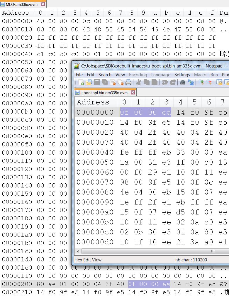

#1. When to use MLO-am335x-evm or u-boot-spl.bin-am335x-evm?
    You use the u-boot-spl.bin-am335x-evm file to boot your board through UART. Please, see this link fore more details. For the rest of boot modes like MMC, NAND or TFTP the MLO-am335x-evm file is used.

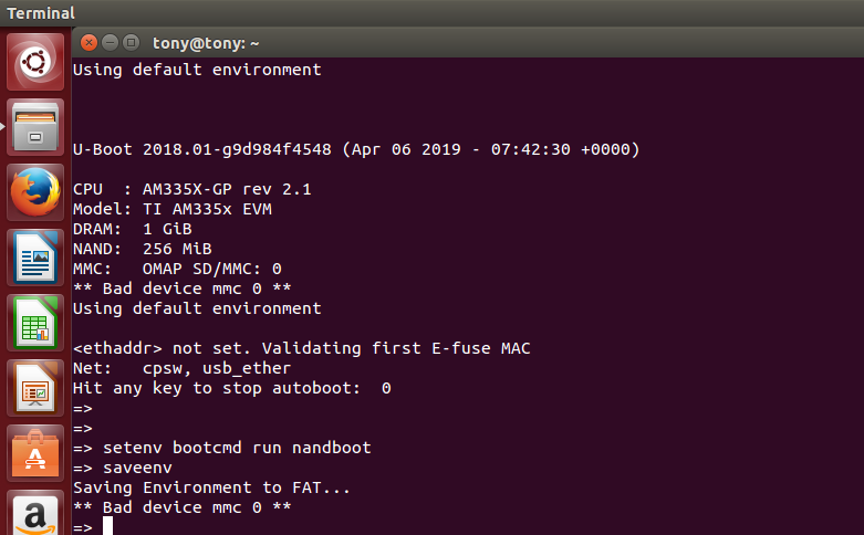

  • I boot from MMC uboot, tftp MLO-am335x-evm, u-boot-am335x-evm.img, zImage-am335x-evm.bin, arago-tiny-image-am335x-evm.ubi and flash to NAND according to mtdparts partitions.
    Then set uboot args
    => setenv nandargs 'setenv bootargs console=${console} ${optargs} root=${nandroot} rootfstype=${nandrootfstype}'
    => setenv bootcmd run nandboot
    => saveenv
    But can't saveenv, . why save to FAT? seems it try to save to MMC.
    Can boot from NAND with flashed uboot, but return same error when saveenv with booting from NAND Uboot.
  • Kernal,
    I tried with PSDK 5.03, similar problem, saveenv default to MMC.
    BTW, I can boot up with run nandboot. just can't saveenv to NAND.
  • Hello Tony,
    To save the environment in a NAND device, please build a new U-Boot image by selecting these menuconfig options.
    $ cd <Processor SDK>/
    $ make u-boot_clean && make u-boot
    $ cd board-support/u-boot-<version>/
    $ ARCH=arm make menuconfig
    Disable [ ] Environment is in a FAT filesystem and enable [*] Environment in a NAND device.
    Environment  ---> [ ] Environment is in a FAT filesystem
    Environment  ---> [*] Environment in a NAND device
    Exit
    Exit
    Do you wish to save your new configuration?
    < Yes >
    $ cp .config configs/am335x_evm_defconfig
    $ cd ../../
    Flash the board with the newly generated MLO and u-boot.img.

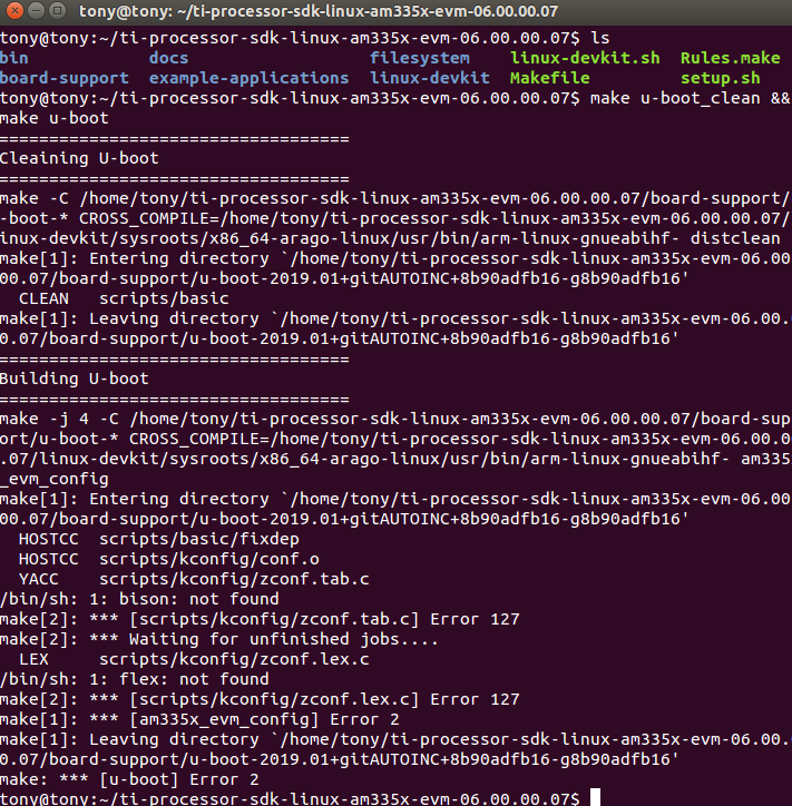

    with the Processor SDK6, I can't build the U-boot. no matter with the make command as you gave under root director of the PSDK, or export CROSS_COMPILE on command line, report the same error.

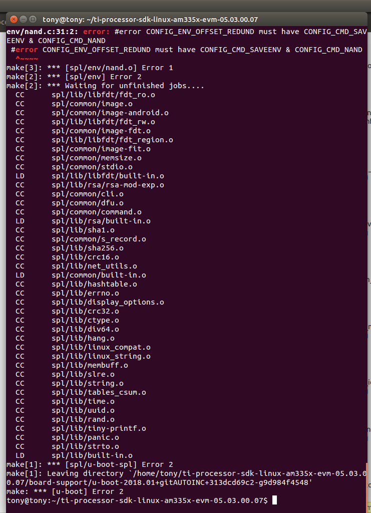

  • On Processor SDK5.03. the final step $ make u-boot_clean && make u-boot reports errors:
  • Hello Tony,
    Please, apply this patch to fix this issue.
    cd <Processor SDK>/board-support/u-boot-<version>/
    git apply 0001-AM335x-Save-the-environment-in-a-NAND-device.patch

  • Please, see the linked articles in this post for Processor SDK 6.0. You need to install the required host packages like flex and bison.
    host$ sudo apt-get install build-essential autoconf automake bison flex libssl-dev bc
