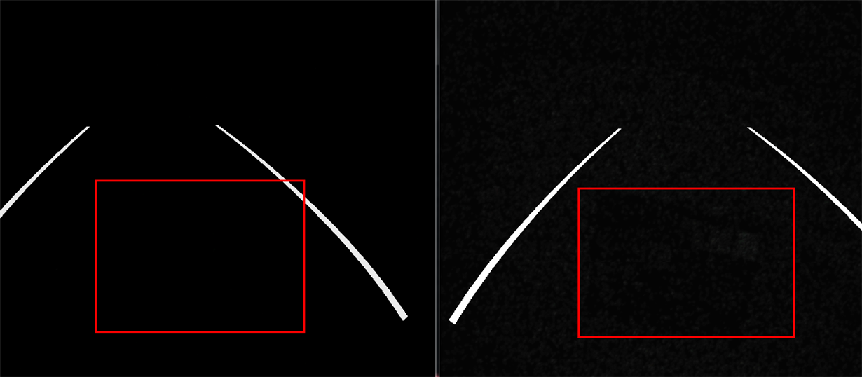

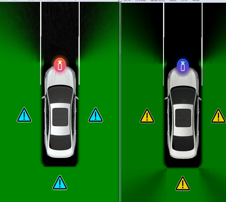

we dump the display buffers, and play the file ,we found that some buffer was RGB32,  some buffer was YUYV,   i don't know why?
the detail folows:
Int32 DisplayLink_drvProcessData(DisplayLink_Obj *pObj)
Vps_printf(" zhoule pFrame address 00 %p %p %d\n",pFrame->addr[0U][0U],pFrame->addr[1U][0U]);
then we used the address for dump, there were seiral buffers for display.
./devmsave  0xa0984000  0x1c2000 dump.txt
then play the dump.txt,  some address  the format was RGB32 ,some was YUYV,why?
specificly,  when pFrame->addr[0U][1U]  was null , the format was YUYV
 pFrame->addr[0U][1U]  was not null , the format was RGB

  • i think a set of buffers(the log about addr[0][0] can show) use for display,
    i wonder why the set of buffers was different ,some was YUYV ,some was rgb at the same time.
  • i ask the question for solving a question.
    the display can show ok in dark situation  (RGB), but not right YUYV at the same situation.
    please help us check  the format config about display.  chains_c53f.c

  • in dark situation,we can see some shadow and white noise in HDMI or dump RGB.
    but in dark situation,dump YUYV , first  the colour was not right , second white noise disppeared.
    please help me check the chain about the format (the engineer dismissed.  i don't know why)
    Please let us know which picture is correct.
    Please post your video stream flow chart and the exact checkpoint where you are dumping the data.

  • the black pictures :right was ok;there was some shadow;
    the car picture: the colour should be yellow,but there was nothing show,should have some shadow;

    Can you please check the SGX output? it looks like SGX is not outputting the image correctly and not blending two images correctly..
