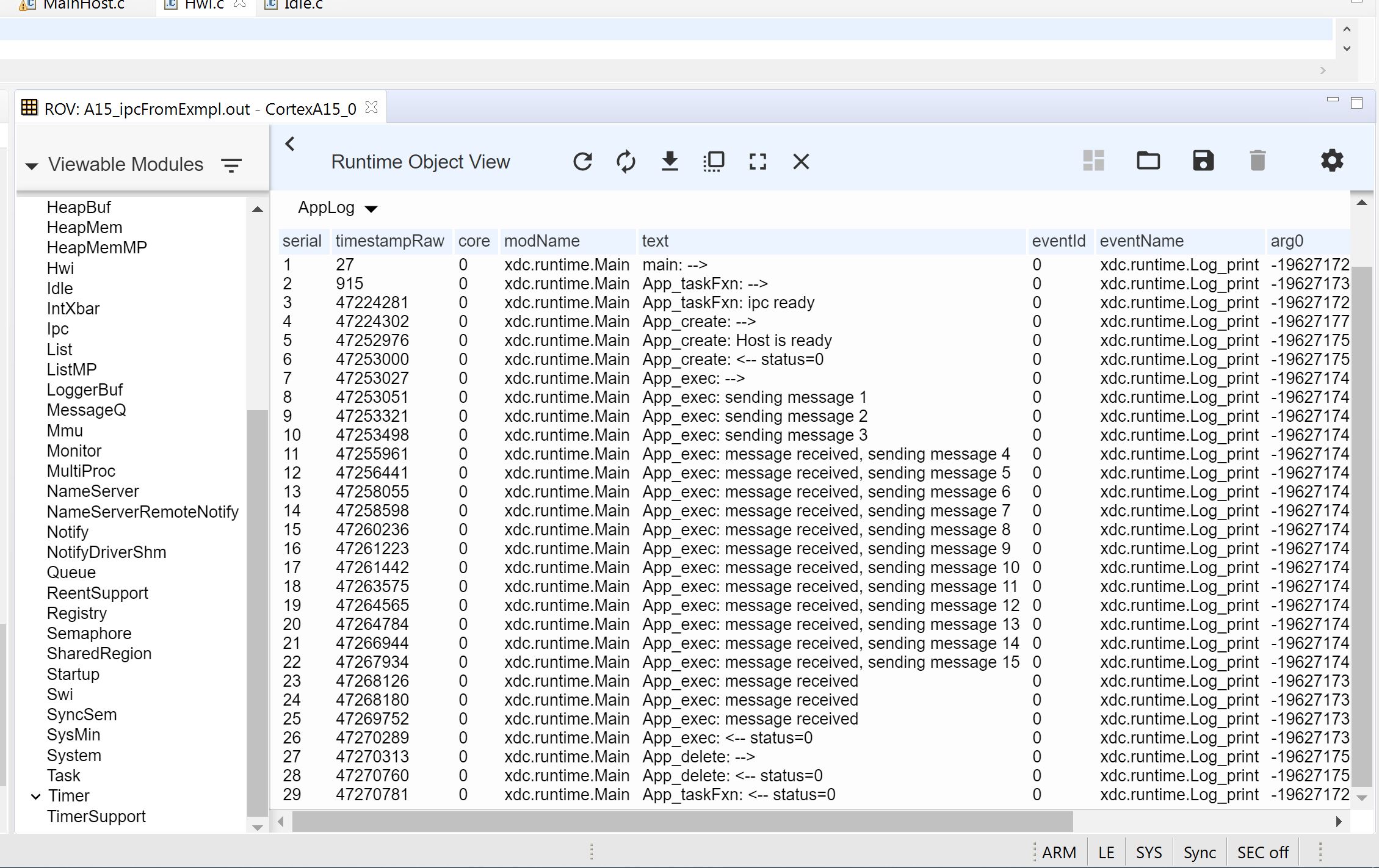

  • OK, still I don't know where I am supposed to enter related input in CCS so that Program.build.cfgArgs can return something instead of null, But, I figured it out by creating an object in my *.cfg files like bellow:
    var Program = xdc.useModule('xdc.cfg.Program');
    Program.build.cfgArgs = {profile:"debug"};  /* i added this line */
    var cfgArgs = Program.build.cfgArgs;
    var RB = (cfgArgs.profile == "release" ? true : false);
    Here is my project folder including cortex-A15 and C66x projects if someone was facing the same issue.
    IPCTestProject001.rar
    and this is the result:
