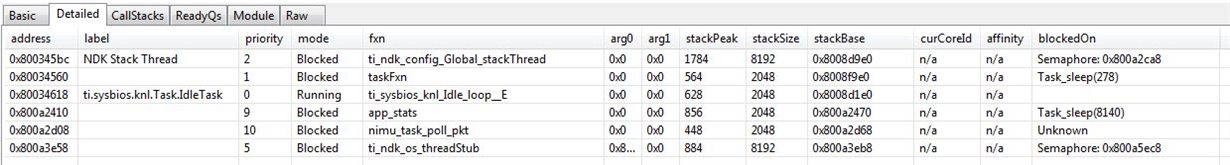

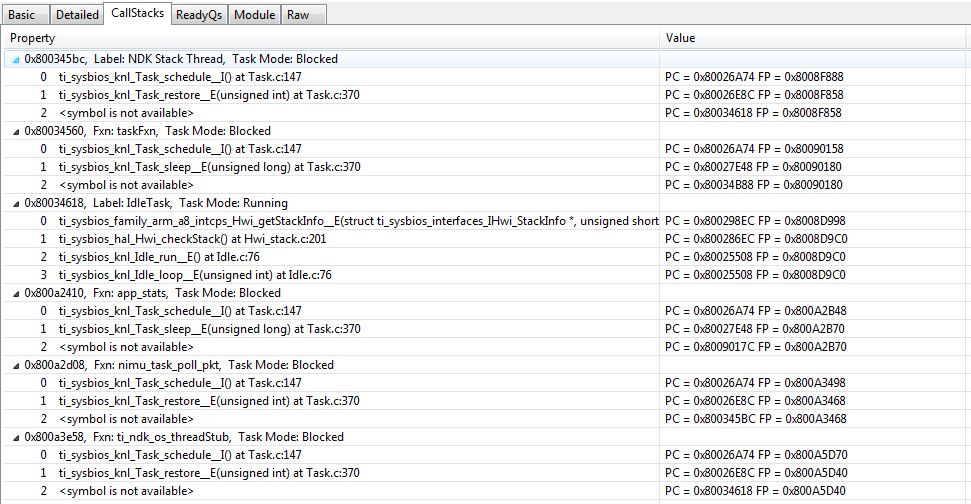

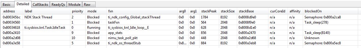

  • Hello Steven,
    I reproduced the issue, stopped the target and did 2 screenshots of the ROV Task data.
    Detailed tab:
    Call stacks tab:
    Kind regards,
    Markus
  • Hi Markus,
    Thanks for those screen shots. Everything is blocked (as you can see), with only the idle task running.
    So, there's no "energy" coming in to get things moving. I'm wondering if you are even getting any RX interrupts from the EMAC?
    When the problem happens, can you try putting a break point at the ISR functions? I don't know this driver very well, but I think it should be these functions (in the same cpsw_nimu_eth.c Iding pointed you to above).
    nimu_rx_pkt_cb()
    (hopefulling lding can confirm).
    So, maybe you should restart the app, set the b/p, then run and verify that you hit it for RX traffic.
    After you verify, unset and reproduce the issue. Then set the b/p again. Do you still hit the b/p?
    Steve

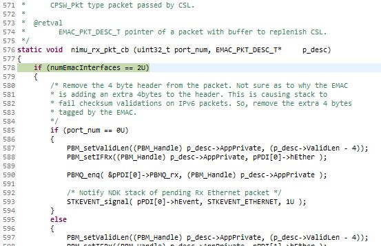

  • Hello Steven,
    I was able to set a breakpoint in this function.
    The breakpoint is hit continously in working condition.
    I reproduced the issue, stopped the target and set the breakpoint.
    If I send traffic (e.g. ICMP Echo), the breakpoint is still hit.
    I resumed (CCS F8 key or the "play symbol") the target several times hitting the breakpoint several times.
    But the more often I resumed the target, the longer it takes to reach the breakpoint again.
    After some more "resumes" the breakpoint was not hit anmore regardless if I am "pinging" the AM3352 or not.
    Event if I don't have active traffic (checked by WireShark), the "TcpTimeoutRexmt: Retransmit Timeout" messages continue to appear in  the console.
    For verification: I have set the breakpoint at the following location:
    Markus
