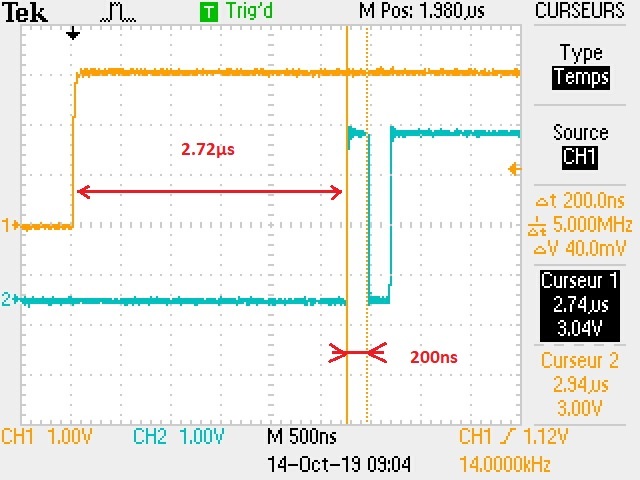

I run a baremetal DSP software that manage two ISR. The ARM is empty. The first one is an interrupt generated by the rising edge of the input capture ECAP1, and the second is generated by the comparaison event of the EPWM module. The ECAP ISR allows to force the synchronization of the EPWM and to measure in the same time the frequency of the input signal.
I measured the time between the rising edge and the effective input into the ISR (by toggling a GPIO), which is around 3µs. I don't understand why...
Could you help me to figure out how to minimize this delay, that should be close to zero?
Sylvain.

  • Hi Brad,
    I attached the capture of the signals after having implemented what you suggest.
    The LED write() macro is around 200ns.
    Sylvain.

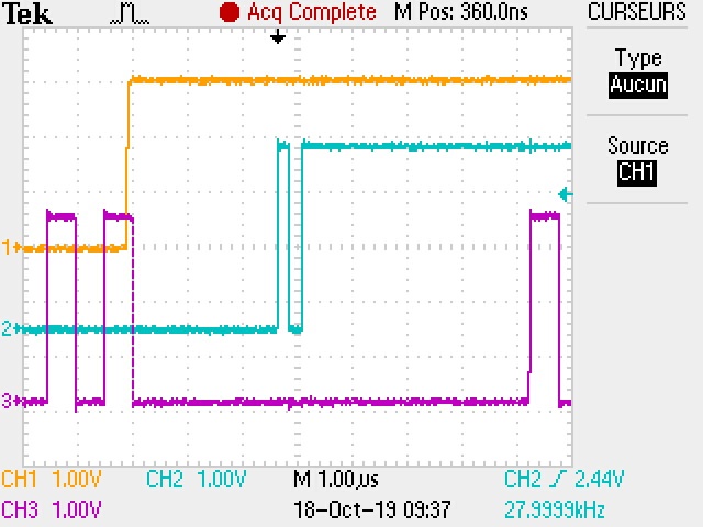

  • Sylvain,
    Sorry, I'm traveling this week, so my responses are very delayed.  I'm trying to understand what's happening precisely.  The GPIO toggling is reasonably fast in your screenshot.  I'm wondering if you can add one more element to this test.  Can you toggle a different GPIO repeatedly as part of a background loop and display that signal on the scope along with the other two?  In particular I'm trying to understand whether the delay is in recognizing the interrupt or in actually executing your specific code.
    Along similar lines, how is your interrupt configured?  Which HWI is it mapped to?  Is it mapped directly, or are you leveraging the interrupt combiner?
    Brad
  • Hi Brad,
    Your suggestion is very interresting. I implemented a fast GPIO toggle in the background task (purple curve) and we see in the draw that the background task is stopped quickly after the "yellow" rising edge. That means that the interrupt is reached but take a while to execute the code in the ISR.

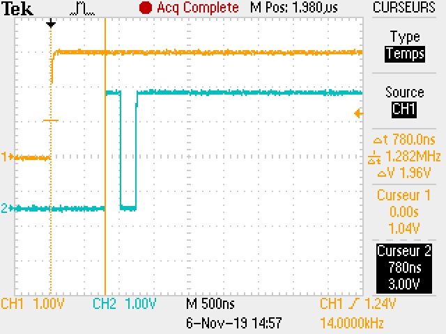

  • Hi Brad,
    I modified the CSL to route the combined output to IRQ12 to 15. I mapped DSP_IRQ_32 to IRQ4 et DSP_IRQ_33 to IRQ5:

  • After compiling the CSL, the result is very bad. I still jump to the ISR but completely asynchronously with the ecap input which is the source of the interrupt.
    In the attached file, I removed the events 32 and 33 to respect the steps (1) that you said. This time, I only modify where the combined output are routed (I modifiied the mask accordingly), and normally I should find my 3us dealy that I had initially. But this time, I don't jump into ISR anymore.
    Could you please take a look to the attached file?

  • Hi Brad,
    I'm about to evaluate the TI-RTOS, by implementing the same things that we discussed previously, so that I can compare the behaviour I had with baremetal.
    So, now with RTOS, I jump to the ecap ISR, but this time with a latency about 780ns, without any modification inside the CSL and OSAL libraries. It's much more better that my 3us I had in the same configuration in baremetal (if you remember)
    I still have around 220ns to toggle the GPIO, so the real latency is about 500ns actually
