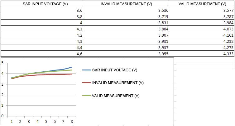

Below there are measurements shown of the input voltage (from a power supply), and the SAR measurement for a production board that we consider "in tolerance" and valid, and one that is "out off tolerance" or invalid/inconsistent, with respect to the majority from previous experience. Measurements done at same temperature.
The graphs give a better indication of what goes on. The blue curve is relatively well followed by the green curve up to a value of about 4.4Volts input after which there is some divergence which would not be of concern for a Li-Ion battery system. However the "out-off tolerance" red curve begins diverging at about 3.8V, so earlier than expected, based on all previous experience with 1000+ production boards tested so far.

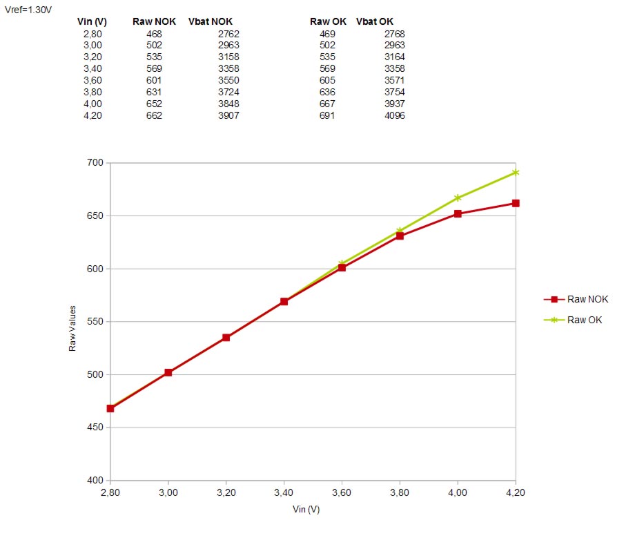

    So I had a bit of time too look into this a little further and I can confirm the 10-bit raw values duirectly obtained from the software are shown below for thwo different custom boards (one that is out of spec and the one that is as expected and that we've always observed). The raw 10-bit SAR value obtained starts saturating at about Vin-3.6 Volts with respect to the other PCB. This then is scaled to give the mV reading which is also saturated. In both cases the Vref = 1.3V from the LDO, and the voltage divider scale is 49.9K || (49.9K + 182K) = 465 multiplier, so we take (10-bit raw x 13 x 465 ) / 1024 to give us the scaled value in mV.
    So basically I'm bewildered about the possible source of this divergence in SAR value measurements.

    The actual offset value obtained when running this routine does not seem to be large, and certaily in the order of 1 - 4 (raw value) so about 1 -  2%. Cannot really get enough % to explain saturation at larger end of inputs.
    However I am wondering about the reference of 1.3V LDO we used, as internal references are given of the order of 0.8V and 1.0V, and this probably for a good reason.... We use an external reference of 1.3V and the voltage divider introduces a x0.216 voltage input attenutation factor, but I wonder if this could be the source ?!?
