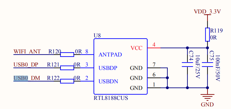

We designed AM335X USB0 as usb host only, the schematic and dts settings are same between USB0 and USB1.
But the USB devices can be recongnized by USB1, and USB0 can't detect the usb devices, Why?
Below are the related schematic and dts setting for your reference.
Please give me some advice to resolve this issue.
TaoTao Wang
    Try removing R54.
    Please post what Linux version you use.
  • Hi, Biser
    The problem hasn't resolved after removing R54, Our Linux version is 4.1.18.
    Best Regards
    Taotao Wang
  • Hi Taotao,
    The schematic shows RTL8188 is permenately connected to USB0 interface, what is connected to USB1?
    Please attach the full kernel boot log.

  • Hi Bin
    USB1 connected with 4G module.
    USB0 connected with this Wifi module.
    Now the 4G module can be detected ,but Wifi can't be found.
    The attached includes the boot log and shell scripte results for your reference.

    [    1.521590] omap_voltage_late_init: Voltage driver support not added
    [    1.528783] ThumbEE CPU extension supported.
    [    1.533319] Registering SWP/SWPB emulation handler
    [    1.540845] omap-gpmc 50000000.gpmc: GPMC revision 6.0
    [    1.546227] gpmc_mem_init: disabling cs 0 mapped at 0x0-0x1000000
    [    1.554168] nand: device found, Manufacturer ID: 0x2c, Chip ID: 0xdc
    [    1.560925] nand: Micron MT29F4G08ABADAWP
    [    1.565144] nand: 512 MiB, SLC, erase size: 128 KiB, page size: 2048, OOB size: 64
    [    1.573114] nand: using OMAP_ECC_BCH8_CODE_HW ECC scheme
    [    1.578760] 11 ofpart partitions found on MTD device 8000000.nand
    [    1.585141] Creating 11 MTD partitions on "8000000.nand":
    [    1.590800] 0x000000000000-0x000000020000 : "NAND.SPL"
    [    1.597424] 0x000000020000-0x000000040000 : "NAND.SPL.backup1"
    [    1.604678] 0x000000040000-0x000000060000 : "NAND.SPL.backup2"
    [    1.611743] 0x000000060000-0x000000080000 : "NAND.SPL.backup3"
    [    1.618864] 0x000000080000-0x0000000c0000 : "NAND.u-boot-spl-os"
    [    1.626091] 0x0000000c0000-0x0000001c0000 : "NAND.u-boot"
    [    1.633070] 0x0000001c0000-0x0000001e0000 : "NAND.u-boot-env"
    [    1.640082] 0x0000001e0000-0x000000200000 : "NAND.u-boot-env.backup1"
    [    1.647828] 0x000000200000-0x000000a00000 : "NAND.kernel"
    [    1.657258] 0x000000a00000-0x00000e000000 : "NAND.rootfs"
    [    1.738695] 0x00000e000000-0x000020000000 : "NAND.userdata"
    [    1.847160] i2c i2c-0: of_i2c: modalias failure on /ocp/i2c@44e0b000/tps@2d
    [    1.854529] omap_i2c 44e0b000.i2c: bus 0 rev0.11 at 400 kHz
    [    1.861674] omap_i2c 4802a000.i2c: bus 1 rev0.11 at 100 kHz
    [    1.868514] ubi0: attaching mtd9
    [    2.714728] ubi0: scanning is finished

    Populating /dev using udev: [    4.174901] pinctrl-single 44e10800.pinmux: pin 44e1082c.0 already requested by 4830e000.lcdc; cannot claim for gpio-leds
    [    4.243543] ===========================am_phy->dr_mode = 1
    [    4.275249] tp reset gpio=-2
    [    4.294866] 47401300.usb-phy supply vcc not found, using dummy regulator
    [    4.309548] pinctrl-single 44e10800.pinmux: pin-11 (gpio-leds) status -22
    [    4.338289] msg ft5x0x_i2c_rxdata i2c read error: -121
    [    4.352022] pinctrl-single 44e10800.pinmux: could not request pin 11 (44e1082c.0) from group pinmux_leds_pins  on device pinctrl-single
    [    4.365924] ft5x0x read ID error!
    [    4.379610] ===========================am_phy->dr_mode = 0
    [    4.385747] 47401b00.usb-phy supply vcc not found, using dummy regulator
    [    4.419382] ft5x06_ts: probe of 1-0038 failed with error 161
    [    4.432100] sgtl5000: probe of 1-000a failed with error -121
    [    4.439722] ft5x0x_ts_init successful
    [    4.451315] leds-gpio gpio-leds: Error applying setting, reverse things back
    [    4.507604] pinctrl-single 44e10800.pinmux: pin 44e10834.0 already requested by 4830e000.lcdc; cannot claim for 481cc000.can
    [    4.569318] pinctrl-single 44e10800.pinmux: pin-13 (481cc000.can) status -22
    [    4.576709] pinctrl-single 44e10800.pinmux: could not request pin 13 (44e10834.0) from group dcan0_pins_default  on device pinctrl-single
    [    4.629991] PM: bootloader does not support rtc-only!
    [    4.667107] davinci_evm sound: ASoC: CODEC DAI sgtl5000 not registered
    [    4.681915] c_can_platform 481cc000.can: Error applying setting, reverse things back
    [    4.700582] davinci_evm sound: snd_soc_register_card failed (-517)
    [    4.709530] davinci_evm sound: ASoC: CODEC DAI sgtl5000 not registered
    [    4.728608] davinci_evm sound: snd_soc_register_card failed (-517)
    [    4.765535] davinci_evm sound: ASoC: CODEC DAI sgtl5000 not registered
    [    4.798349] davinci_evm sound: snd_soc_register_card failed (-517)
    [    4.844779] davinci_evm sound: ASoC: CODEC DAI sgtl5000 not registered
    [    4.888239] davinci_evm sound: snd_soc_register_card failed (-517)
    [    5.202943] davinci_evm sound: ASoC: CODEC DAI sgtl5000 not registered
    [    5.234052] davinci_evm sound: snd_soc_register_card failed (-517)
    [    5.346810] davinci_evm sound: ASoC: CODEC DAI sgtl5000 not registered
    [    5.362727] davinci_evm sound: snd_soc_register_card failed (-517)
    [    5.377181] davinci_evm sound: ASoC: CODEC DAI sgtl5000 not registered
    [    5.387342] davinci_evm sound: snd_soc_register_card failed (-517)
    [    5.399879] davinci_evm sound: ASoC: CODEC DAI sgtl5000 not registered
    [    5.406719] davinci_evm sound: snd_soc_register_card failed (-517)
    [    5.426647] davinci_evm sound: ASoC: CODEC DAI sgtl5000 not registered
    done
    [    5.448223] davinci_evm sound: snd_soc_register_card failed (-517)
    Initializing random number generator... done.
    Starting system message bus: done
    Starting network: [    5.868353] usb 1-1: device descriptor read/64, error -71
    [    5.951117] davinci_evm sound: ASoC: CODEC DAI sgtl5000 not registered
    [    5.957952] davinci_evm sound: snd_soc_register_card failed (-517)
    [    6.008834] davinci_evm sound: ASoC: CODEC DAI sgtl5000 not registered
    [    6.015771] davinci_evm sound: snd_soc_register_card failed (-517)
    udhcpc: started, v1.25.1
    [    6.037306] davinci_evm sound: ASoC: CODEC DAI sgtl5000 not registered
    [    6.055768] davinci_evm sound: snd_soc_register_card failed (-517)
    [    6.098156] usb 1-1: device descriptor read/64, error -71
    udhcpc: sending discover
    [    6.448017] usb 1-1: device descriptor read/64, error -71
    [    6.678006] usb 1-1: device descriptor read/64, error -71
    [    7.328008] usb 1-1: device not accepting address 4, error -71
    [    7.868015] usb 1-1: device not accepting address 5, error -71
    [    7.874143] usb usb1-port1: unable to enumerate USB device
    udhcpc: sending select for 192.168.0.210
    udhcpc: lease of 192.168.0.210 obtained, lease time 7200
    deleting routers
    adding dns 221.179.155.161
    adding dns 221.179.155.177
    OK
    Starting sshd: OK
    Starting DHCP server: FAIL
    ok
    DACHUANTEK login: root

    # lsusb -t
    Bus 002 Device 002: ID 19d2:1476
    Bus 001 Device 001: ID 1d6b:0002
    Bus 002 Device 001: ID 1d6b:0002
    # [   61.498202]  remoteproc0: failed to load am335x-pm-firmware.elf
    [   61.505170]  remoteproc0: Direct firmware load for am335x-pm-firmware.elf failed with error -2
    [   61.519007]  remoteproc0: Falling back to user helper
    # cd
    # ls
    3441.chkusb-0.2.10.sh
    # chmod 755 3441.chkusb-0.2.10.sh
    # ./3441.chkusb-0.2.10.sh  > usb0_host.log
    grep: /sys/kernel/debug/musb-hdrc.?/regdump: No such file or directory
    # cat usb0_host.log
    chkusb.sh Version 0.2.10
    Linux DACHUANTEK 4.1.18 #1 PREEMPT Tue Nov 5 17:33:27 CST 2019 armv7l GNU/Linux
    USB is initialized
    Warning: CONFIG_USB_OTG defined.
    musb-hdrc.0.auto: mode a_suspend, Vbus off, timeout 1100 msec
    musb-hdrc.1.auto: mode a_host, Vbus off, timeout 1100 msec
    usb@47401000: host, (null)

  • Hi Taotao,
    The kernel log shows the USB0 port is in suspend state, we probably have to figure out what causes it.
    Can you please run the following command on your board Linux console to dump a couple USB registers?
    # devmem2 0x47401401 b
    # devmem2 0x47401460 b
    Is the 4G module connected to USB1 through a USB port? or the module is permanently on the board similar to the wifi module on USB0?
    The TI kernel v4.1.18 was released in 2015 and no longer supported on this forum. There have been many musb bug fixes since 2015. Are you able to test the latest Processor SDK to see your board still have the same issue?
  • Hi Bin,
    The memory dump results as below.
    # devmem 0x47401401 b
    0xE2
    # devmem 0x47401460 b
    0x3D
    As for the hardware schematic, the USB0 is same as USB1.
    The LTE module is also permanently connected with the USB1 similar with Wifi module.
    There is much work payload for kernel porting to latest version, we will discuss it.
    Best Regards.
    Taotao Wang
  • Hi Taotao,
    The register value indicates the Wifi module is detected as a low-speed device. Is it really a low-speed device? If not, please check your board layout to ensure USB0 DP and DM pins are not swapped with the DP and DM pins on the Wifi module.
  • Hi Bin,
    You are right! The DM DP pin of wifi module PCB footprint  are swapped.
    After exchanged the sigals, the wlan0 has worked.
    Thanks for your great support!
    TaoTao Wang
  • Hi TaoTao,
    I am glad the issue is solved. Thanks for the update.
