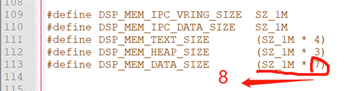

Our customers need to expand the size of EXT_DATA when developing DSP applications.

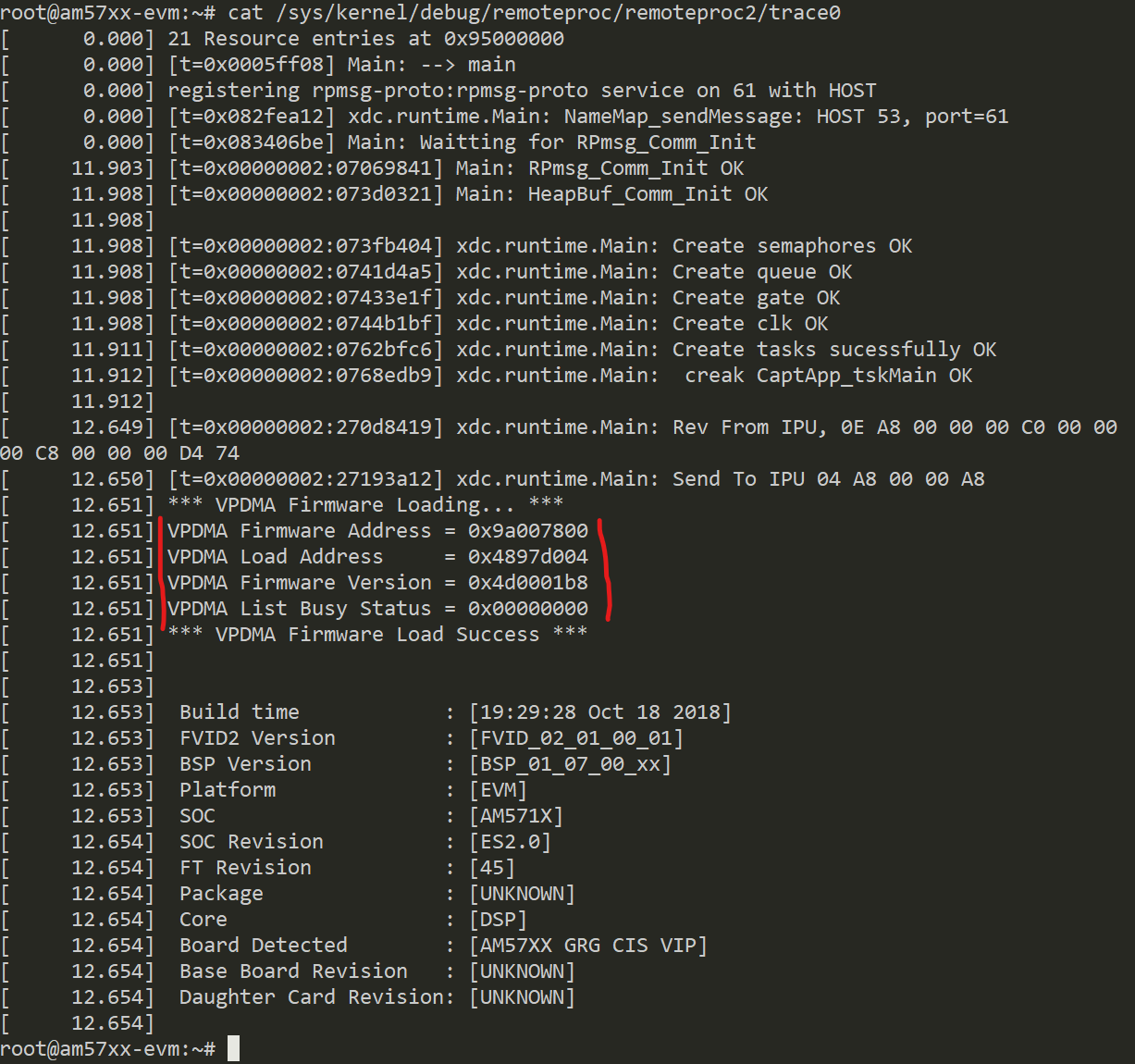

But after the expansion, it was found that only a part of DSP application was started.

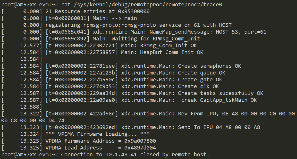

The log of the original normal startup is as follows:
The logs that cannot be started normally after expanding memory are as follows:
config.bld/rsc_table.h:

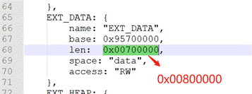

7268.rsc_table.h
Memory expanded from 7M to 8M. The modification method is as follows:
The processor we use is am5718
Linux is running on A15
Linux SDK version 03.01.00.06
RTOS version 03.01.00.06
Do you have any suggestions
