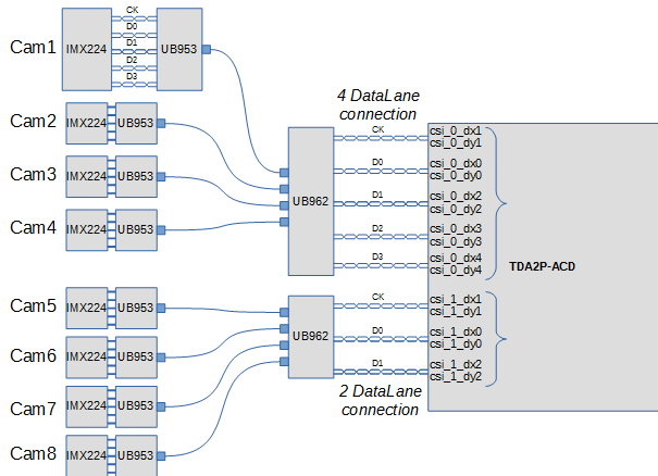

We're planning to connnect 8 cameras to TDA2P-ACD using only csi-ports (csi_0 with 4 DL config and csi_1 with 2 DL config), please, see picture below.
(1) Is it possible to connect 8 cameras using both csi-ports only (with dual UB962)?
(2) We already tested UB962 with TDA2P using only csi_0 port in 4 DL mode. It works fine with 4 cameras!
Now we want to try UB962 (4 cameras) with csi0_port in 2 DL mode.
Which steps we need to do for using 2 DL connection?

    Please find answers to your questions below.
    1, yes, 8 channels is possible, provided CSI BW is enough.
    2, i did not get this. Are you trying to enable 2L on CSI inst0? In this case, we also need to change ub962 configuration.
    Rgds,
    Brijesh
  • Hi Senchuss,
    In addition to what Brijesh has mentioned. Presuming that VisionSDK is being used.
    1. Configure UB962 to stream on 2 lanes
    2. Determine the CSI2 clock speed that's being configured in UB962, configure the same in csi2PhyClk
    3. Configure the Capture Link to receive on 2 lanes (refer file vision_sdk\apps\src\rtos\usecases\csi2_cal_multi_cam_view\chains_csi2CalMultiCam.c and function setCaptureParams () )
      1. ensure to turn-off un-used lanes
    Regards, Sujith
