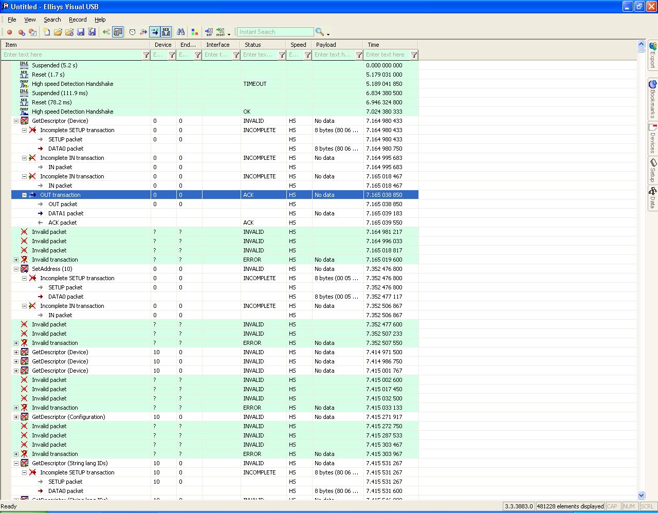

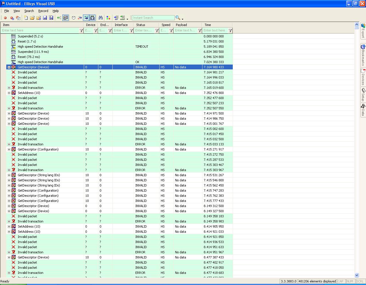

  • Ya, i am using Ellisys USB Analyzer.
    Attached is the data during the eunmeration in high-speed mode.
    There are lots of  "Invalid packet" and "Invalid transaction" which I don't see if it is enumerating in full-speed mode.
  • The first transfer shows "Get descriptor" and data section says "No DATA" . Do you see any valid data inside this transfer (you can open '+') ? I am wondering how SET address and other commands can proceed when there is no valid data in first transfer itself.
    Ajay
  •  As I expand the "GetDescriptor" and "SetAddress", I can see "Incomplete SETUP transaction".
    What is missing is there is no Handshake Packet after SETUP packet and DATA0 packet.

  • For complete SETUP transaction, i will see the below packet.
    -> SETUP packet
    -> DATA0 packet
    <- ACK packet (this is the Handshake Packet that is missing and cause the "Incomplete SETUP transaction" error)
