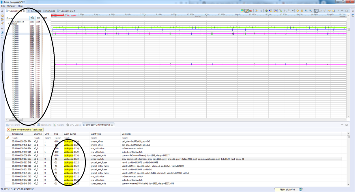

Multiple Thread are being created. we want to understand why so many threads with high priority  is being created. If they are not  required we would like to strip down certain threads.
Please find attached image.

  • Hi Raghu,
    Some threads might be removed.
    Every Link in Link framework is running in a thread.
    When the Vision SDK Link framework is initialized, each registered Link by default will create a thread.
    Those Links will be created and stay in idle even if your use case is not using those links.
    If you have only one specific use case to run in your system, you can remove the unused Links so they won't be created.
    Please refer to System_initLinks() in ~/vision_sdk/links_fw/src/hlos/system/system_common.c.
    You can comment out the calling of init function for the unused Links.
    Stanley

  • Could you put a "printf" in OSA_thrCreate() under ~/vision_sdk/links_fw/src/hlos/osa/src/osa_thr.c?
    We can see if the thread is created by the Link framework or not? Link framework will create thread via calling this API.
    Stanley
  • Hi Stanley,
    We would like to name this threads, currently all are named as "VSDKAPPS" we can't identify which thread is being created.
    Raghu
  • Hi Raghu,
    pthread has API to add name to a thread. It is documented in Linux API. You can look it up. However, I was not able to find where those threads are created so I am not sure where you can add the call to do this.
    If you can connect GDB debugger, you can trace the apps.out to find where the threads are created.
    Can you do that?
