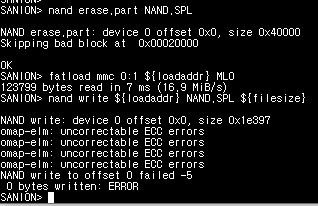

    M_NAND_GPMC_CONFIG1 is set to 8 bits.
    However, when I do erase.part on u-boot and wirte, I get the following error message:
    ECC is using BCH8.
    Do I need to modify my ECC?

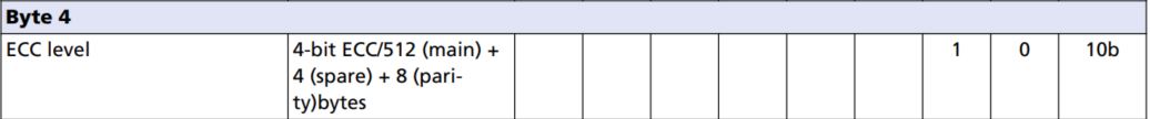

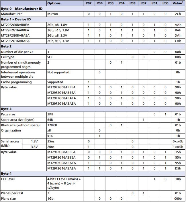

    My NAND Flash has a byte4 of id 10h. Do you have to use bch16 in this case?
    bch16 cannot be used due to size issues.
    Is there any other way?

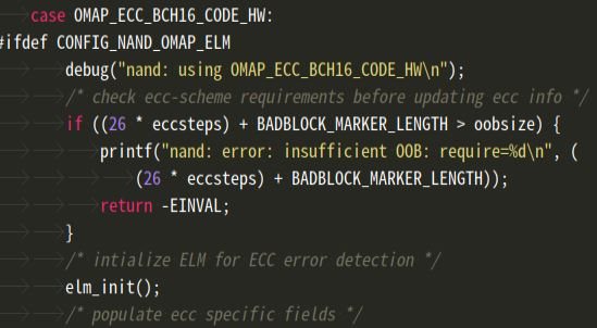

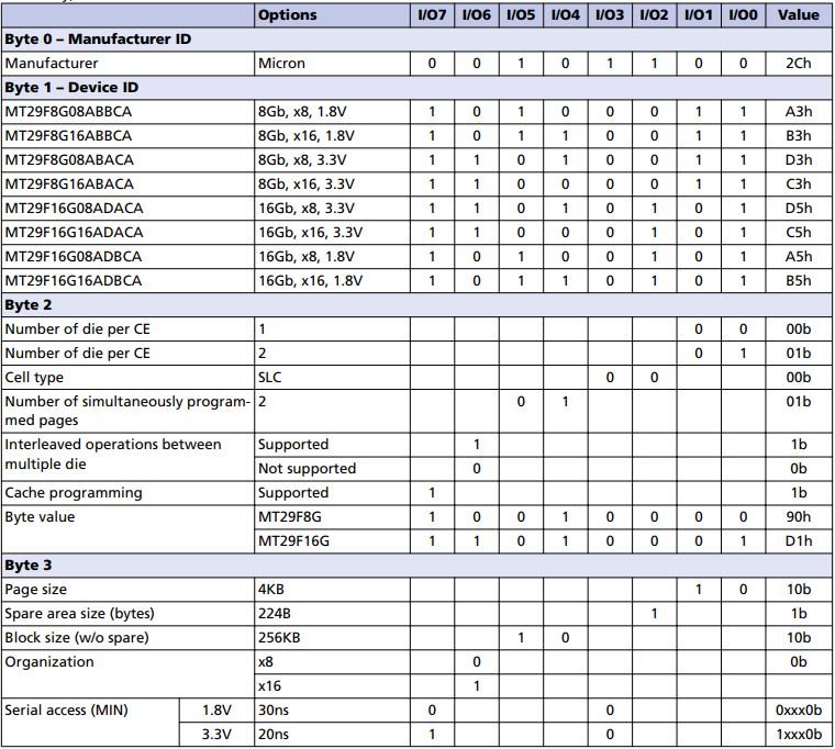

    In the case of phytec-am571x board, nand flash is used as below. The size calculation does not indicate a problem with the BCH16.
    But when I use my nand flash bch16, there is a problem with the size and it prints out an error. So I use bch8 but I get an ecc error.
    phytec bsp nand flash datasheet:
    I suspect the following.
    Other nand flash is reserved but my nand is defined as above. Can you find out if there are any changes that need to be made?
    After removing EEC Define, we could check the r / w operation. It seems to handle ecc part inside nand flash.
    Can I boot SPL from NAND even if I use it this way?
