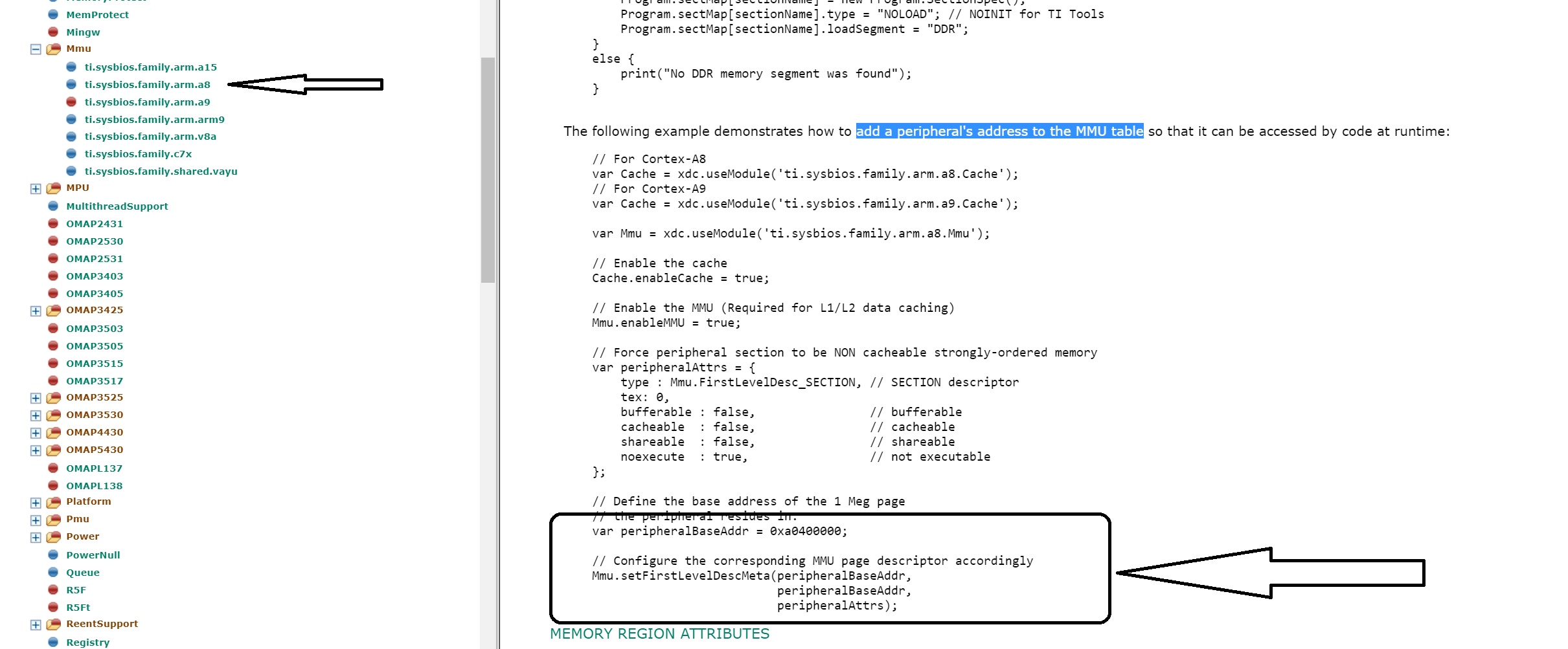

Hello.
I am trying to figure out how to properly configure. xxx.cfg file. I have some confusion with the MMU module. In the SIS/BIOS API documentation the MMU is describe and an example is given how correct it's do.
But in the examples, which is included in SDK, MMU have another code.
Unfortunately, I could not find the documentation where the configuration is described as in the example. Could you help with the documentation to understand why this is done in the example?
