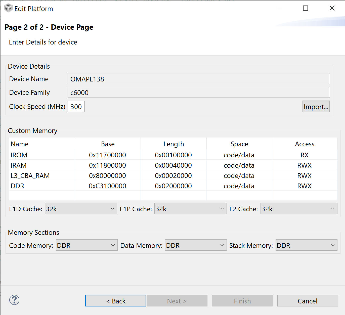

4. Platform memory setup
5. *.cfg configuration file
