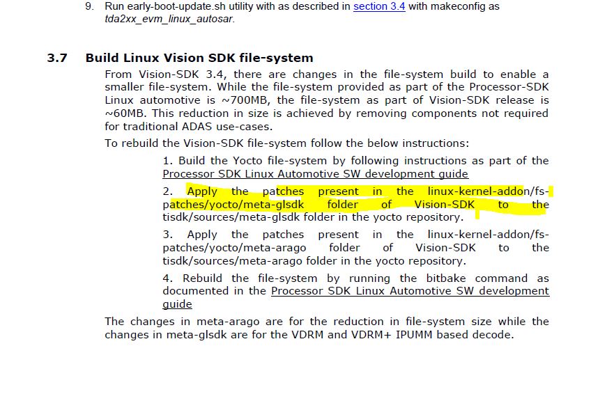

Hi Team:
Customer develop their TDA2Sx system. file system base on website latest 6.00.00.03 (https://processors.wiki.ti.com/index.php?title=Category:Processor_SDK_Linux_Automotive)
VSDK use linux version 3.6 release.
Develop system is Ubuntu 14.04
first time build total Yocto default J6x filesystem is size is ~1GB. Based on our user guide description use small size file system script build file system tar package about ~150MB.
Could you please share small size of 60MB file system with us or help us double check the file system we generate is wrong or not?
I upload the file system to TI internal BOX. you can download it.
Best Regards!
han tao

  • Hi Tao,
    VisionSDK 3.02 to 3.07 were based on PSDKLA3.0x(kernel 4.4 and u-boot 2016.05).
    VisionSDK 3.08 is based on PSDKLA6.00(Kernel 4.19 and u-boot 2019.01).
    VisionSDK3.7 has filesystem size of ~90MB always and not ~60MB.
    http://software-dl.ti.com/processor-sdk-vision/esd/TDAx/vision-sdk/03_07_00_00/index_FDS.html
    VisionSDK3.08 filesystem is ~120MB
    http://software-dl.ti.com/processor-sdk-vision/esd/TDAx/vision-sdk/latest/index_FDS.html
    We have disabled exactly same recipes here but size is not coming down too 90MB.
    Can you let us know your usecase, we can disable few more recipes based on your usecase.
    For example, if gstreamer is not required, we can disable all gstreamer recipes and it will further reduce the filesystem size.
    RamPrasad
