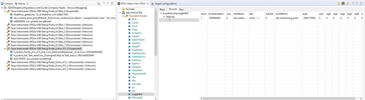

    Follow your suggestion, I have built the binary files of example ex02_messageq for ARM and DSP. Then I follow the step on the processor SDK guide:
    1. Conntect target for 8 DSPs (DSP_Core0 to DSP_Core7) and ARM_Core0
    2. Load the binary accordingly
    3. Start the ARM core, then strat the DSP from core 0 to core 7
    4. Wait for sometime, then suspend all the core.
    5. Open ROV
    From the LoggerBuff I only see one line is printed (with the text "-> main:"). It looks like the program hang somewhere. Could you please advise how to debug this?
    Also in my previous post. I am looking for how to create a ARM RTOS project using CCS, for my future project, not only for running the example of IPC. Any suggestion on that?
    Thanks a lot.
    The ex02_message example is for communicating between the ARM and only 1 DSP core. By default, it expects core 0. You should only connect and load to DSP core 0 and the ARM core.
    If you want communication between all cores then the ex11_ping example would better suit you.
    For creating the CCS project, you can start a new SYSBIOS project for TCI6636K2H by going to File > New > CCS Project. Make sure to add the required files (including the shared folder), the compiler and linker options from the makefile, and update the platform specified in the makefile, e.g. for core 0 it is "ti.platforms.evmTCI6636K2H:core0". You can update the platform in project properties > General > Products > Platform.
    Sahin
  • Hi Sahin,
    Even I run DSP Core 0 and ARM Core 0 only, I still have same issue as below:
  • Hi Sahin,
    It seems like when the ARM is running, it stucks at the source file C:\ti\bios_6_76_02_02\packages\ti\sysbios\family\arm\a15\smp\Core.c
    From what I understand is that since useSkernelCmd is set to false, we need to use GEL file to wake up secondary cores, but I am using C:\ti\ccs920\ccs\ccs_base\emulation\boards\xtcievmk2x\gel\xtcievmk2x_arm.gel and I cannot find what is the function to do so.
    Please advise how to solve this issue. Thanks.
    As we discovered in your other thread, it was due to the example expecting to be run in SMP mode.
    https://e2e.ti.com/support/processors/f/791/t/887358
    I will close this thread now.
