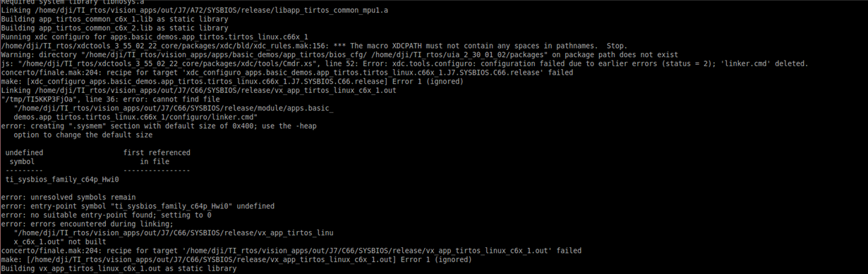

  • hi  all:
    I modified vision_apps based on the above information and compiled but found that the path (/home/dji/TI_rtos/uia_2_30_01_02/packages)could not be recognized.It seems the reason is that XDC_IDIRS cannot add multiple paths.
  • Sorry, this compilation error has been resolved
