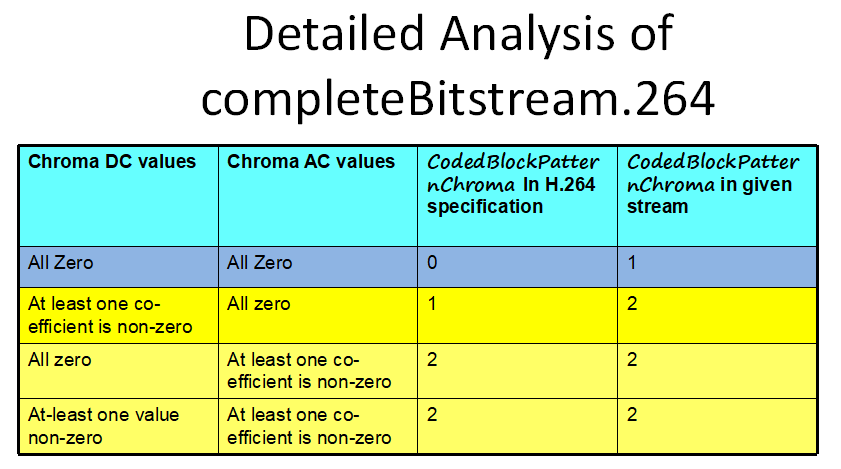

  • Hi RamPrasad,
    CBP(coded_block_pattern) is a macroblock layer syntax element. CBF(coded_block_flag) is a residual block cabac layer syntax element. According to the
    ITU-T Recommendation H.264, this two syntax elements all  specify whether the block contains non-zero transform coefficient levels. But there should be no conflicts between them, reasons as follow:
    1. when CBP is equal to 0, there will be no residual data then no CBF
    2. when CBP is equal to 1, the CBF can be 1 or 0
    So I'd like to know what is the mismatch between CBP and CBF actually means?
    Peng

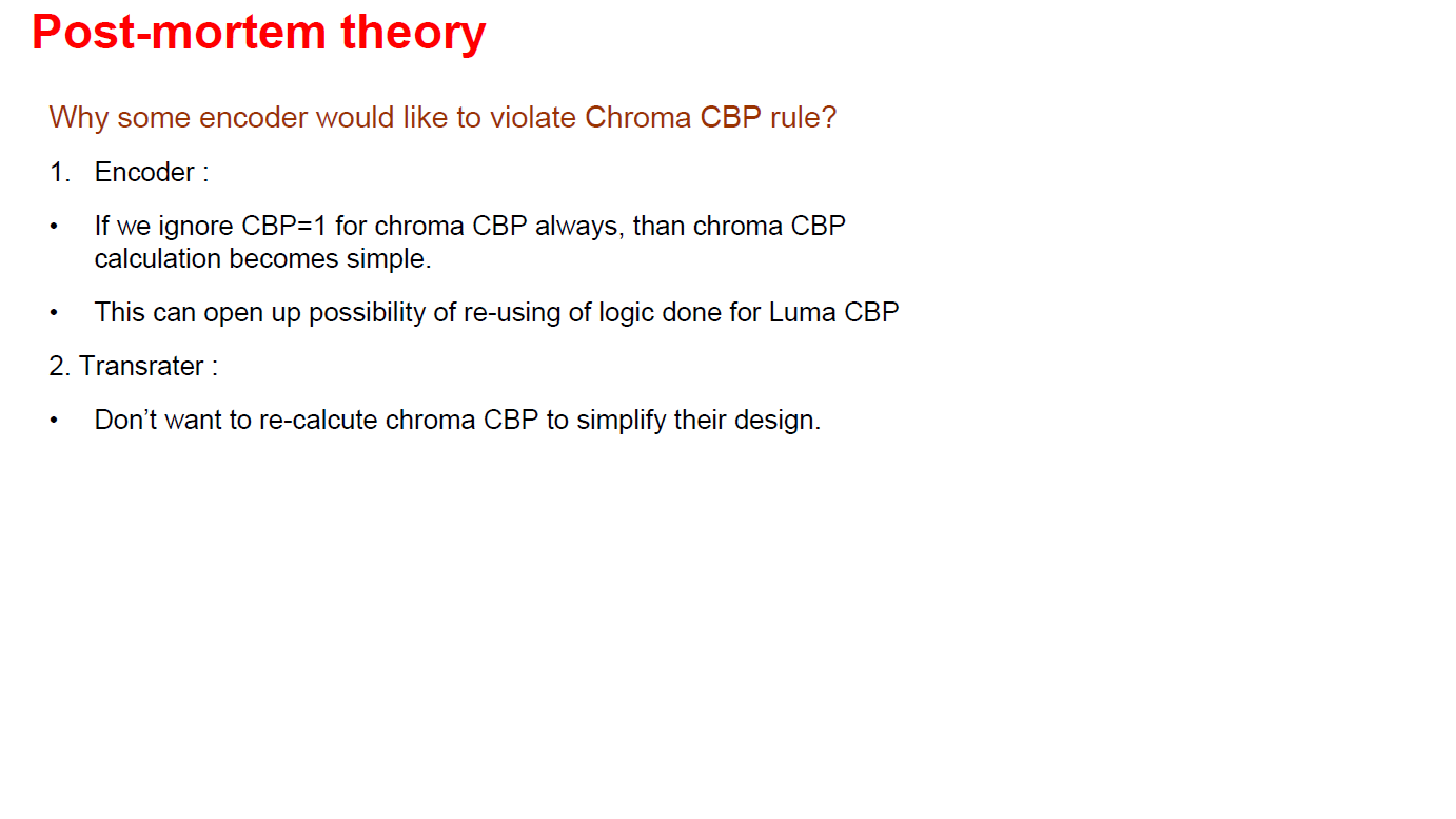

  • Hi Peng,
    Please find the details of the issue in the attached ppt.
    This will give information on how encoder is violating the standard for CBP rule.
    DM814x_H264Dec_Issue.zip
    RamPrasad
  • Hi RamPrasad,
    Are there any  methods or suggestions to avoid this problem at encoder side?
    Peng
  • Hi Peng,
    The ppt I shared should  give the detailed information of what encoder should generate.
    Did you go through?
    Ram

  • Hi Peng/Denny,
    I found this snapshot what should be done at encoder. Please find it. It may help you.
    I have one command line executable to check if there is a cbp mismatch in a stream and which macroblock, I will share with you.
    Ram
