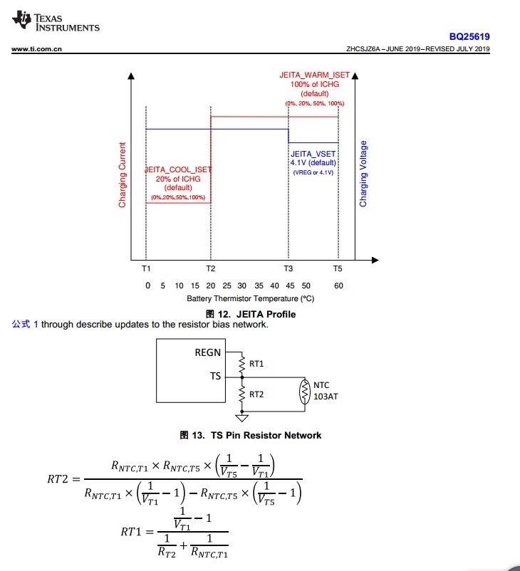

BQ25619: How to set RT1 and RT2, so that the IC in the temperature range of 15~45℃ normal charging, not in this range on the suspension of charging?Is there a calculation table for BQ25619 TS NTC?
Expert 2630 points
Part Number: BQ25619
R25          10      k ohm +/-       1           %
  B(25/50)      3380       K +/-         1           %
   TEMP.       R-low      R-center     R-high
  (deg.C)     (k ohm)     (k ohm)     (k ohm)

       This part employs JEITA according to industry standard JEITA guideline. Sizing the RT1 and RT2 resistors give you control over what temperature the T1 and T5 thresholds correspond to. In the datasheet, the example they take is to set T1 = 0C and T5 = 60C. You can adjust RT1 and RT2 according to your expected T1 and T5 thresholds (based off of the thermistor you have chosen), and then calculate what T2 T3 T4 thresholds will be.
