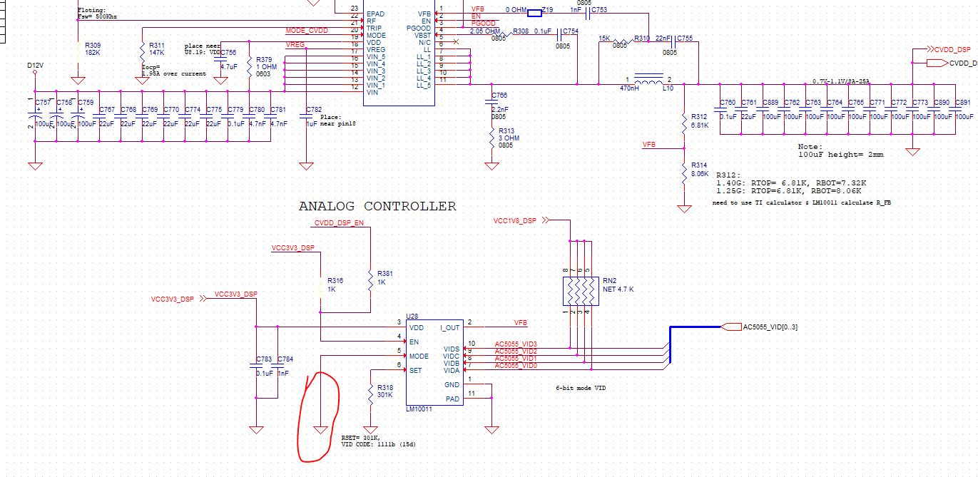

Can I short the Mode pin of LM10011 to the GND for both 1.25Ghz and 1.4Ghz without PD resistor? (CVDD line)
Shay,
Yes, it can be tied directly to ground to enable the 6-bit VID code on the 4-pin interface.
