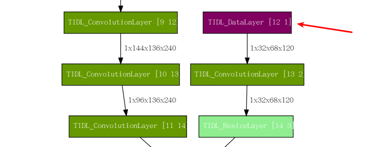

If I have 2 models:ModelA and ModelB, if the input of ModelB is the output of ModelA.
When I use 8-bit quantization, the output layer of ModelA is uint8 with a scale and a pair of Min-Max value.
How can I set the scale and the pair of Min-Max value of the input datalayer of ModelB.

    This doesn't completely solve my problem. I have 2 input in ModelB. The scale of input_1 is s_1 and the scale of input_2 is s_2.
    I have set that:
    inQuantFactor = s1 s2
    inDataNameList = "input_1, input_2"
    But in the trace log I can see the scales of input_1 and input_2 are both s1.
    Can I set the scale for the two inputs separately?

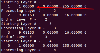

    This param "orgTIDLNetStructure.TIDLPCLayers[i].outData[0].tensorScale" of different inputs are indeed set to different values.
    But in trace log the scales printed for the different inputs are the same.
    I can't see the code of TIDL inference lib, so I can't figure out where is wrong.

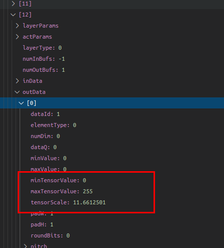

  • I looked into the net file generated by TIDL import tool.
    "TIDLLayer[0].outData[0].tensorScale" of Input_1 is s1(1.0) and  "TIDLLayer[1].outData[0].tensorScale" of Input_2 is s2(15.0).
    That is correct.
    But in the following trace log:
    The scales are the same.  s2 should be 15.0.

    Can you confirm the release version that you are using? If it is the same. Did you make any changes to the import tool?
    For QAT model also, only scale value needs to be set for data layers.Min and Max values are not required.
  • My release version is the same with yours.
    The first layer of my model is resizelayer,  Will this have an impact?
  • We don't expect it to change based on Layer type.
    Did you make any change in the TIDL tools?
  • And The next layer of resize layer is eltwise layer.
    The min-max values and scales of Resizelayer and eltwiseLayer are all calculated from the parameters of the previous layer.( Do I understand correctly ?)
    So I think the min-max values should also be passed.
  • The only change I make in the TIDL tools is that I add a resize layer( as shown following). Because in onnx opset10 the upsample layer is defalut named as "resize" rather than "upsample".

    Processing config file #0 : /home//psdk_rtos_auto_j7_06_02_00_21/tidl_j7_01_01_00_10/ti_dl/utils/tidlModelImport/tempDir/qunat_stats_config.txt
          223518,      0.213 0x7f220259f010
    lance tidl_tb_algCreate createParams.net->TIDLLayers[i].outData[0].tensorScale: layer[0]=1.000000 layer1[1]=11.661250
    tensorScale is correct in tidl_tb_algCreate()

  • I dumped the params stored in the net.bin, and found the scales are correct.
    But in the console log, the params of layer12(aka.datalayer2) are totally different. And the final result is wrong.
    And the scale of the next layer's indata is also correct.
  • There is some issue inside TIDL(version 1.1.0.10, in PSDKRA 6.2).
    You can set "quantRangeUpdateFactor = 0.0" in import config to avoid this issue.
