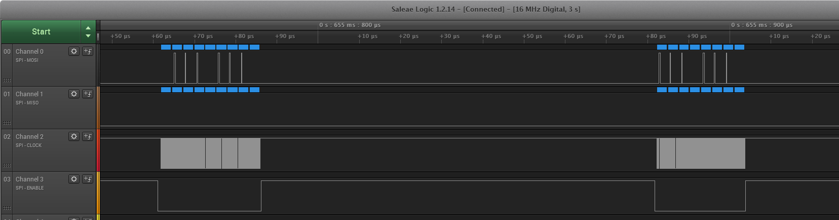

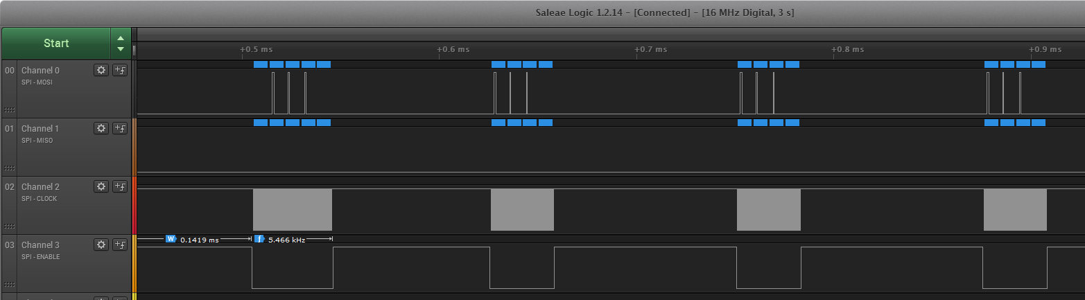

I'm using EDMA3 to hold the SPI data transfer base on th C6748 starter-ware. SPI DMA event is enabled in Timer ISR function every 125us and disabled in DMA ISR after 4 16-bit words were transferred. But it does not work as I expected.
For example, when the SPI_CLK was 2MHz, I monitored  the SPI bus with logic analyzer, I found that 5 16-bit words were transferred in the first turn and 4 16-bit words were transferred in other turns.
For another example, when the SPI_CLK was 6MHz, I monitored  the SPI bus with logic analyzer, I found that 9 16-bit words were transferred in the first turn and 8 16-bit words were transferred in other turns.
I only want to transfer 4 16-bit words every 125us, but it doesn't work as expected. Please give me some suggestions. Thanks!

    Yes, I successfully performed SPI transfers without EDMA. And I also successfully performed SPI transfers with EDMA by setting the linkaddr of transfer paRam to 0xFFFF and loading new paRam of SPI transfers in EDMA ISR. But if setting the linkaddr to another paRam for auto reloading, the EDMA transfer complete interrupt won't happen properly when paRam is exhausted. So it appears problem above and I wonder why.

    And Yes, the data transferred is correct but in wrong order because of 5 words were transferred in first turn other than 4 words in 2MHz clock case. When I check the IPR, it indicates 0x8000 or 0xC000 and matches the TCC code(14 & 15).
