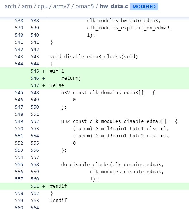

  • Hi, Fan, Wen:
    Please try below approach:
    • revert patch 0002-arm-mach-omap2-Remove-edma-related-nodes-from-hwmod-.patch
    • in uboot (if the uboot exists) : arch/arm/cpu/armv7/omap5/hw_data.c (exact file)
    • in kernel dts (please find the edma setting in your dts)
    The above should be find.
