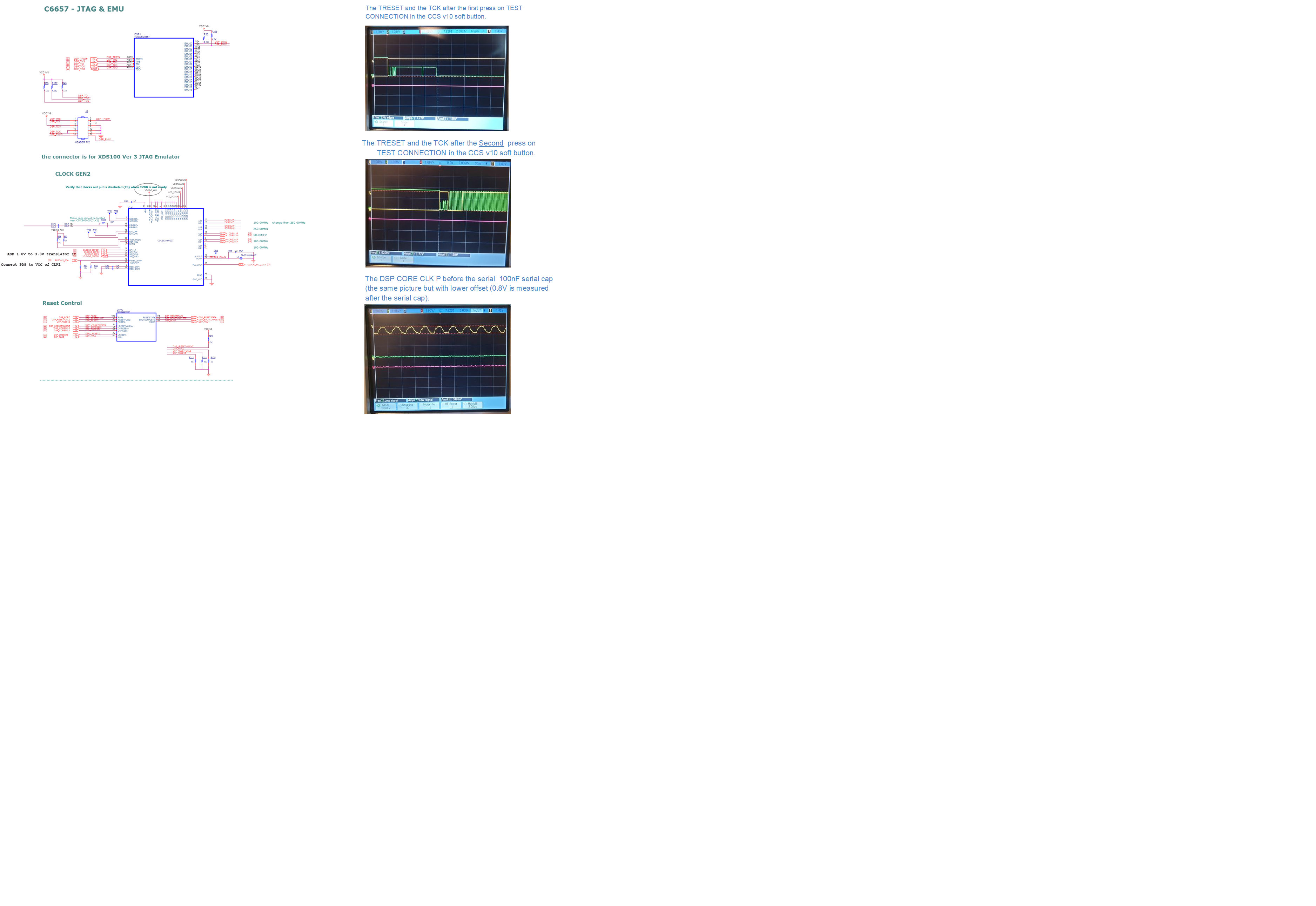

See below  the  board schematics (the relevant)  and some pictures of the TCLK and the CLOCKCOREP 100MHz  signal (before the serial capacitors).
the JTAG connector pin out is:
DSP_TMS   1
DSP_TDI   3
VCC1v8      5
DSP_TDO   7
DSP_TCK   11 and connected also to 9
DSP_EMU0  13
DSP_TRST# 2
NC          4
GND   8,10,12
DSP_EMU1  14
 The TRESET# and the TCK after the first press on TEST CONNECTION in the CCS v10 soft button seems different then in the following presses on TEST CONNECTION.
Sometimes  the CLOCK levels seems between 0 to 0.9V on the trailer and before the proper levels clock signals.
 The TRESET and the TCK after the Second  press on TEST CONNECTION in the CCS v10 soft button  seems as proper clock signals.
The TRESET and the TCK after the first press on TEST CONNECTION in the CCS v10 soft button.
The TRESET and the TCK after the Second  press on TEST CONNECTION in the CCS v10 soft button.
The DSP CORE CLK P before the serial  100nF serial cap (the same picture but with lower offset (0.8V is measured after the serial cap).
(if needed I can send photo of the TCK signal).
The DSP CORE CLK P before the serial  100nF cap is 1.2V offset and about 400mV amplitude  (after the serial capacitor seems the same as before the serial capacitor but with lower offset  0.8V measured after the serial cap).

  • Moshe,
    I am not an expert in the device itself but, from a JTAG emulation perspective, I can see a few details that are different from our recommendations shown in the section Target Design of the XDS Target Connection Guide page below:
    https://software-dl.ti.com/ccs/esd/documents/xdsdebugprobes/emu_xds_target_connection_guide.html
    The pull ups in the TDO/TDI/TMS lines and the absence of a pull down on TRST are the differences I could spot.
    I will defer the other clock and power questions to the device experts.
    Rafael
  • the message from the XDS100 after adding TRSET PD 4.7K res
    (I also connected the TDIS (pin 4)  of the XDS100 to the GND of the target (pin 4 on the JTAG connector of the target was connected also to GND)

    Scan tests: 6, skipped: 0, failed: 5
    Some of the values were corrupted - 83.3 percent.
    The JTAG DR Integrity scan-test has failed.
    [End: Texas Instruments XDS100v2 USB Debug Probe_0]
    I still see that the TDO level stuck on  1.8V without any change.
    I see you did some modifications, but did you also remove the pull up resistors from the TDI/TDO lines? From your schematics and comparing to the reference I sent before, these pull ups are only required when using buffering on the JTAG lines. Your schematics are not showing that.
    If removing the resistor causes the TDO to fall to GND indefinitely, or the last sequence of messages coming from the "Test Connection" routine shows that it "Scanned in 0x00000000", there is a chance this line is not connected to the TDO pin of the device (it is not being driven by any circuit). Perhaps an assembly issue?
    The last error message is consistent with this theory.
    Rafael
