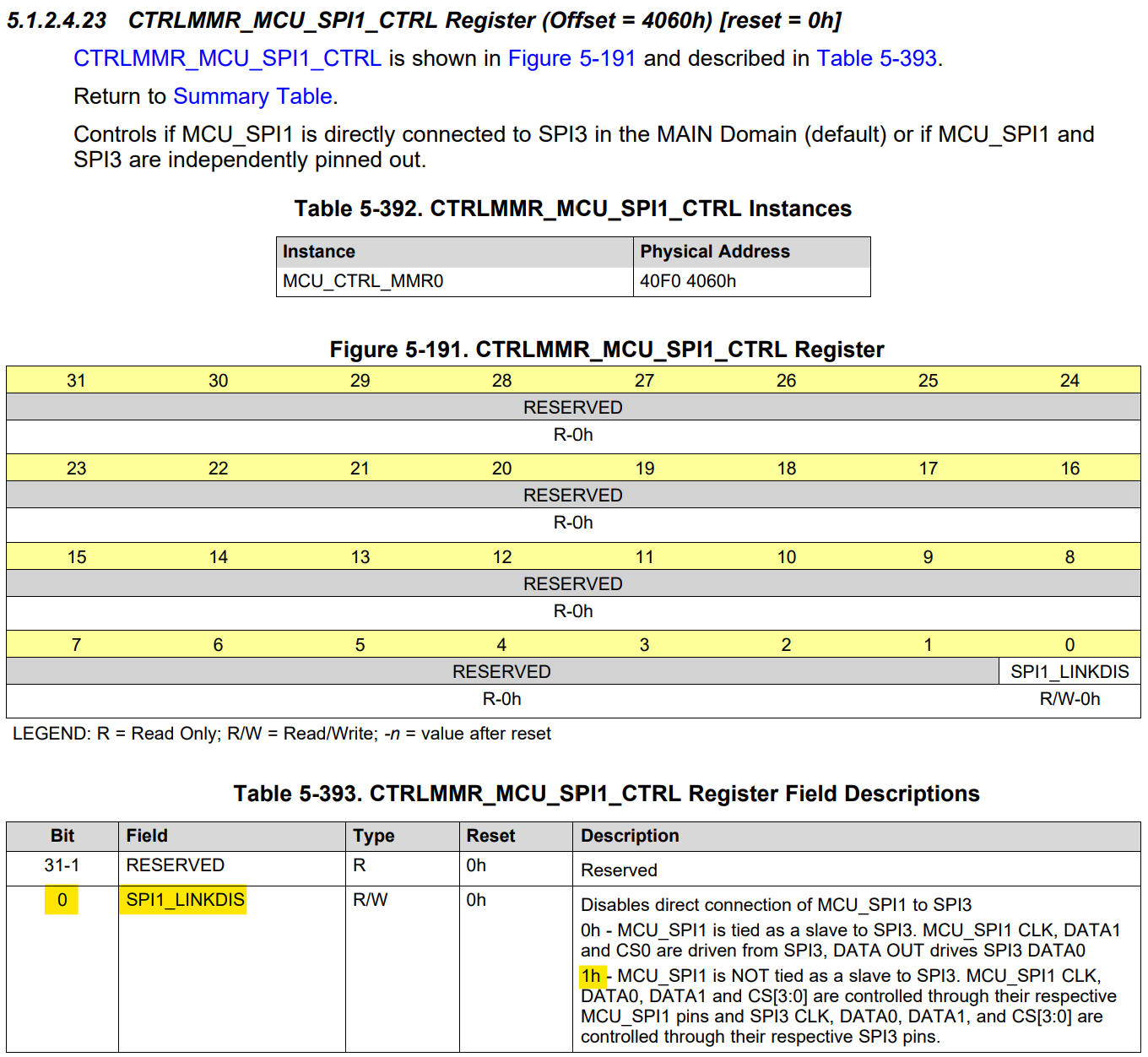

AM6548: mcu_spi1 support on the IDK
Part Number: AM6548
We are having trouble testing SPI loopback using spidev on mcu_spi1 on the AM65x IDK. Using the following devicetree changes, we've enabled mcu_spi1 and spidev:

When connecting the MISO and MOSI signals and running "/opt/ltp/testcases/bin/ddt/spidev_test -D /dev/spidev1.0" included in the Linux SDK, we see no RX activity.
Has mcu_spi1 or any mcu_spi interface been validated in Linux?

  • Hi Matt,
    Snippet from TRM below on MCU SPI instances (Chapter 12.1.4)
    MCSPI3 and MCSPI4 include internal connectivity to MCSPI modules in the MCU domain, as follows:
    • MCSPI3 is connected as a master to MCU_MCSPI1 by default at power-up. MCU_MCSPI1 and MCSPI3 may be optionally mapped to external device pads.
    • MCSPI4 is directly connected as a slave to MCU_MCSPI2 by default at power-up. MCSPI4 and MCU_MCSPI2 are not pinned out externally.
    MCU_SPI1 can be routed to external pin using CTRLMMR_MCU_SPI1_CTRL Register
    Vishal
  • That was the missing link. Thank you.
