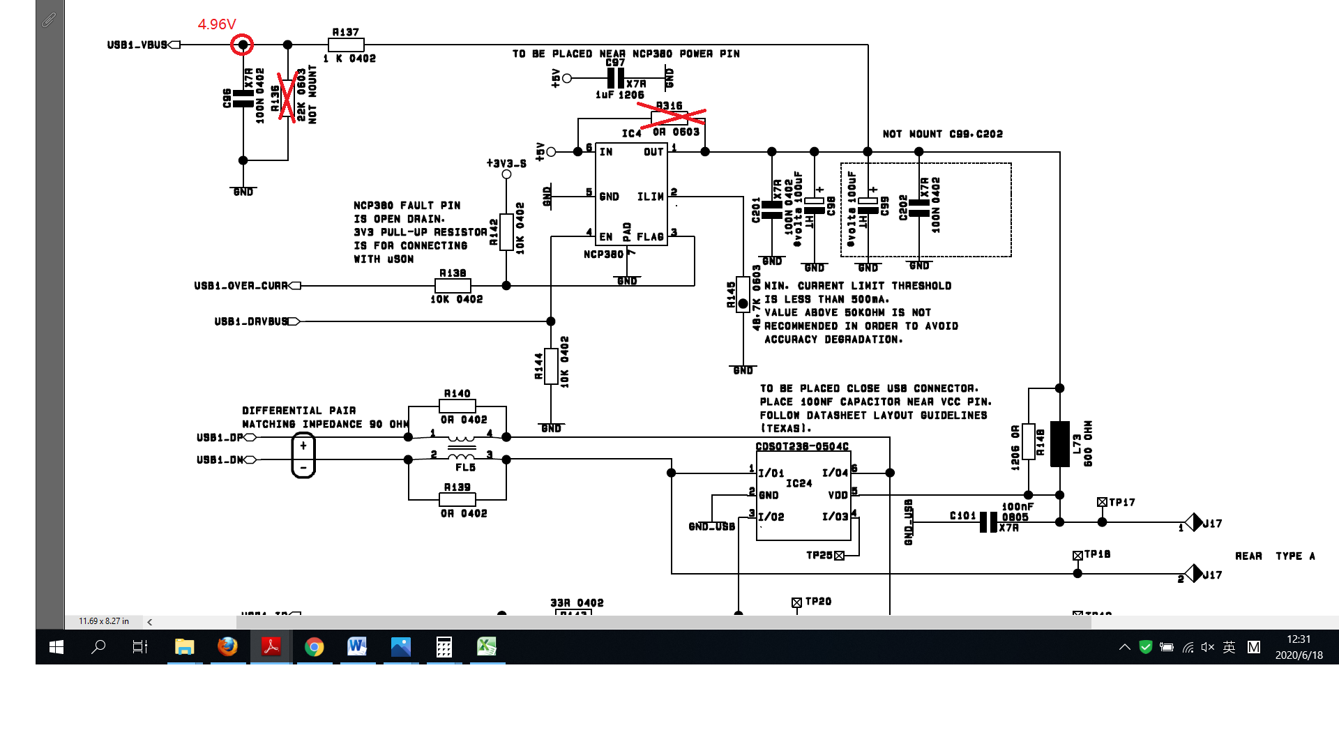

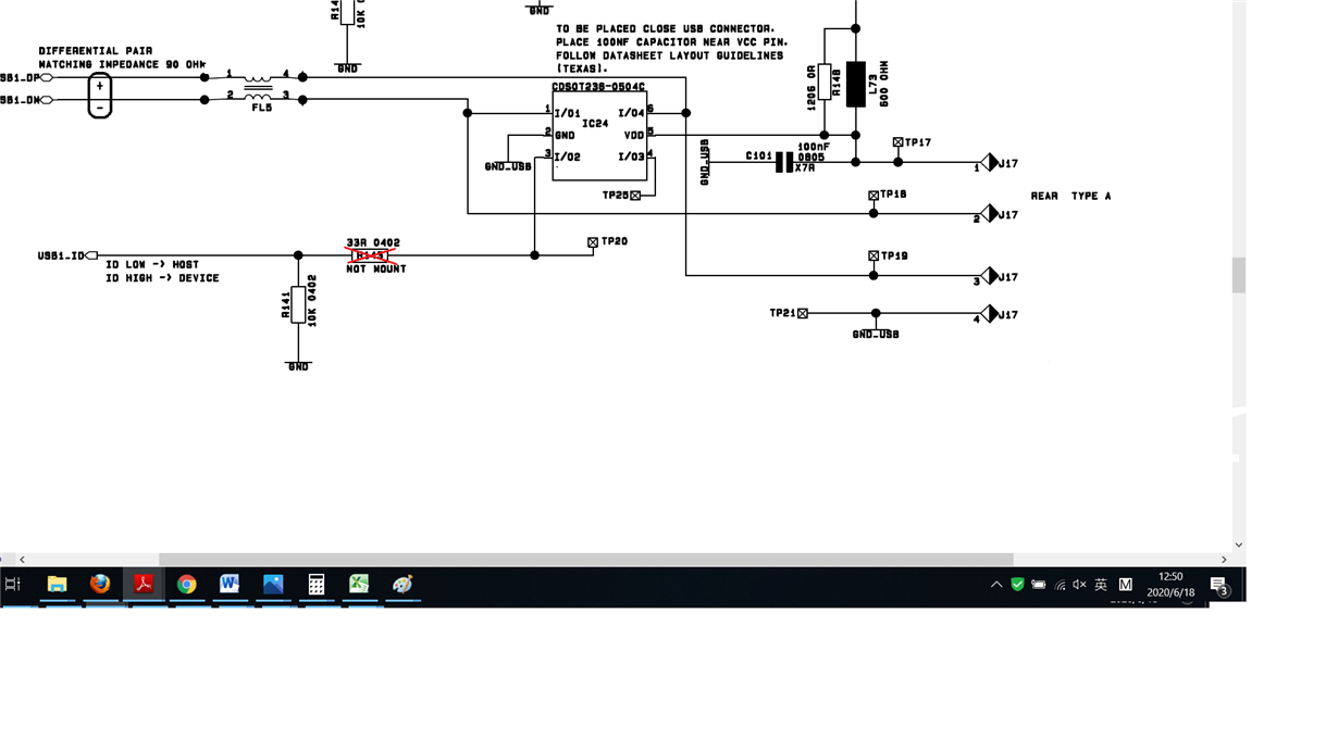

Hi.
I use board with custom hardware, that connect WiFi over USB to am3352. I use mainline Linux 4.8.17.
In my board schematics only USB signal lines (USB1_DM and USB1_DP) connected from CPU to WiFI (but not USB Power line, USB +5V connected from other power supply, and not connected with am3352).
In result I see USB error in dmesg:
[  734.531123] musb-hdrc musb-hdrc.0.auto: VBUS_ERROR in a_wait_vrise (81, <SessEnd), retry #1, port1 0008050c
[  734.683550] musb-hdrc musb-hdrc.0.auto: VBUS_ERROR in a_wait_vrise (81, <SessEnd), retry #2, port1 0008050c
[  734.835977] musb-hdrc musb-hdrc.0.auto: VBUS_ERROR in a_wait_vrise (81, <SessEnd), retry #3, port1 0008050c
[  734.988398] musb-hdrc musb-hdrc.0.auto: VBUS_ERROR in a_wait_vrise (80, <SessEnd), retry #3, port1 0008050c
And USB does not work.
lsusb just show internal hub:
# lsusb
Bus 001 Device 001: ID 1d6b:0002
My device tree (USB part):
&usb1_phy {
    status = "okay";
&usb1 {
    status = "okay";
    dr_mode = "host";
&cppi41dma {
    status = "okay";
i know that USBx_VBUSIN pin should be connected to Valid VBus of >=4.4V, when the musb is configured as usb host, otherwise you will get bus error.
But measured  vbus voltage is 4.96V by oscilloscope,it have more than 4.4V.
Now i start to doubt its cause is not hardware.
1.do you think if its cause is software or not ?
2. NCP380 is related to VBUS error or not ?
3.what is root cause ?
4.How I can fix USB?
  • Hi Jacky,
    Mainline kernel is not supported on this forums. Please use the kernel provided in the TI Processor SDK Linux release. The latest version for AM335x is v6.3.0.106, which has kernel based on mainline v4.19.90.
    Your device tree misses enabling &usb and &usb_ctrl_mod nodes. Please refer to am335x-evm.dts in the kernel source code.
