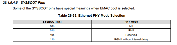

    2.I have read the TRM again,maybe it's the mismatch of the phy mode.
      When I set the sysboot[7:6] to 11b,the phy mode is RGMII without internal delay.

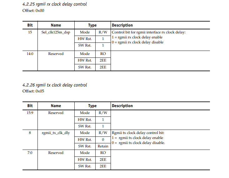

      Refer to the datasheet of AR8035,the default RX_CLK timing is RGMII with internal delay,it should be disabled by modifing the corresponding register in rom code.

      Refer to the datasheet of AR8035,the default RX_CLK timing is RGMII with internal delay,it should be disabled by modifying the corresponding register in rom code.
    That looks pretty much like it's the issue here. I spent a few minutes looking through the AR8035 datasheet, and I don't see a way to control the RGMII clock delay settings via pin strapping options (some PHYs allow that, and it's usually done through the LED pins, hence my earlier suggestion). The AM335x boot ROM will not program those registers for you as far as I understand. So you won't be able to use that particular PHY to boot SPL/U-Boot over network.
