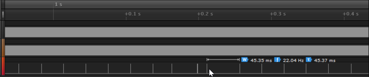

    In analyzer file check in between 7th sec to 8th sec and one more before 9th sec capture. You will observer this behavior. In most of the time usb read trigger will happen every 30 ms. i.e Host will request for data every 30ms. But in some case it is taking more time for data transfer, which in turn the delay is created by 64 Bytes packet delays.Attached the picture for your reference from where to start looking into.

    Captured and attached the logic analyzer related to delays. Refer below screenshot for largest delay. Please let me know if You need some more captures.This capture is taken with DMA enabled.
    In general CMD request will be issued every 30 ms from Host. Most of the time the read is successful and able to receive 4236 Bytes in time approx in less than 10ms. But some times like as I mentioned below. It took more than 30ms  i.e incase of 45ms delays between 64Bytes read took more. Not sure Why?

    I reviewed the logic analyzer capture, but don't see any obvious issue in the DP/DM transactions. In the begining of every "Data Read Trigger" cycle there is about 5~6ms period while data packets are received then followed by IN/NAK transactions until the end of the "Data Read Trigger" cycle. The "45.35ms" cycle you highlighted in your screenshot is the same - Data packets are received for about 5~6ms, then the USB device NAKs all the IN tokens until the next "Data Read Trigger" cycle starts.
    So I don't see any issue in the controller transaction level. But what is the "Data Read Trigger" signal in your capture? How it works? What controls it? How does it generate signals in 30ms interval? Please explain it in more details.

    Data Read Trigger is nothing but starting of First successful data read packet from MCU, just a reference signal. 30 ms is nothing to do with Data Read Trigger. 30ms is something to do with PID OUT triggers(i.e delay between Consecutive PID OUT is 30ms) from HOST. i,e every 30 ms HOST will expect the data from MCU.
    Most of the time data is getting received with in less than 30 ms. But some cases it is taking more time as mentioned in the case of 45.35 ms case. check for delays between 64 Bytes packets after data read trigger you can observe more delay between 64bytes packets. But where as it is not the case for other transactions.
