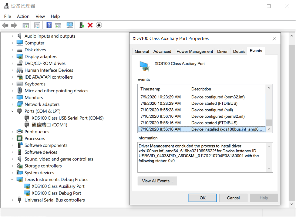

    My connection cable comes with the IDK board.

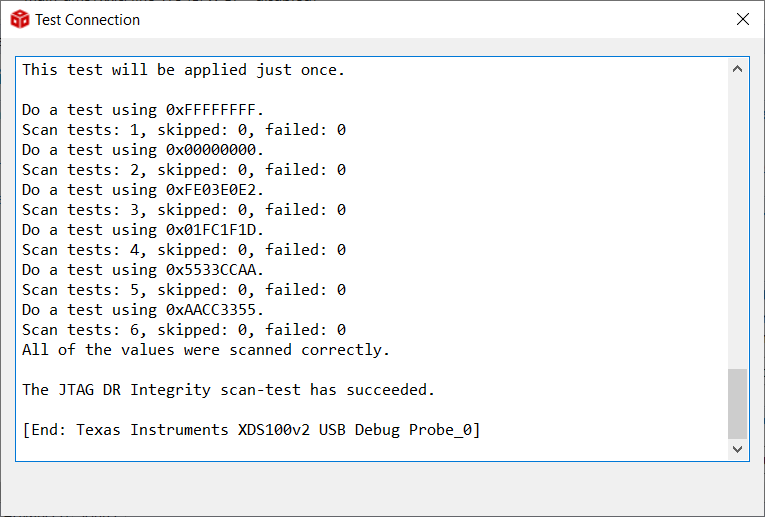

    The following picture shows the xds100v2 driver information of win10.
    The following picture shows the test connect information in CCS.

  • Do you use a bench power supply for the board? If yes, what is the current limit setting?
    If you use power supply plugged into wall, what is the current rating of the power adapter?
    From the CCS error message, it looks like maybe some power glitch to the board.
