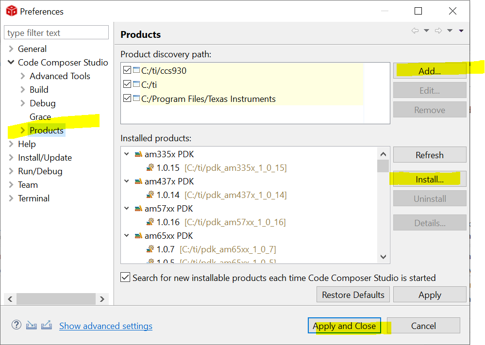

    When you download the Processor SDK RTOS for C6678, the SYSBIOS and CGT are parts of the installer. We typically install it under c:\ti. Then you need to start the CCS 9.3, it will detect the SYSBIOS, PDK, NDK, IPC, EDMA, ....etc installed under the search path (e.g. c:\ti) and register them.
    Then you can run the pdkprojectcreate script to create CCS project.

  • Hi Iding,
    So I do not have space let in C drive and hence had to install the processor SDK in F drive -> ti. I also installed the CCS v9.3 in F drive -> ti folder. As per the documentation, I changes the CCS_INSTALL_PATH to F:/ti/ccs930/ccs in pdkProjectCreate.bat but was getting the above error.
     Can you suggest I do something so that the project generation can happen in this location instead of the C drive? Also what did you mean by "register them"? Can you elaborate?
    Thanks in advance,
    -Chandrasekhar DVS
    If you installed everything to F: drive,
    1) In CCS --------->Window------->Preferences--------->Product to add the search path. Then you can find the SYSBIOS, IPC, .... "Register" I meant "Install".

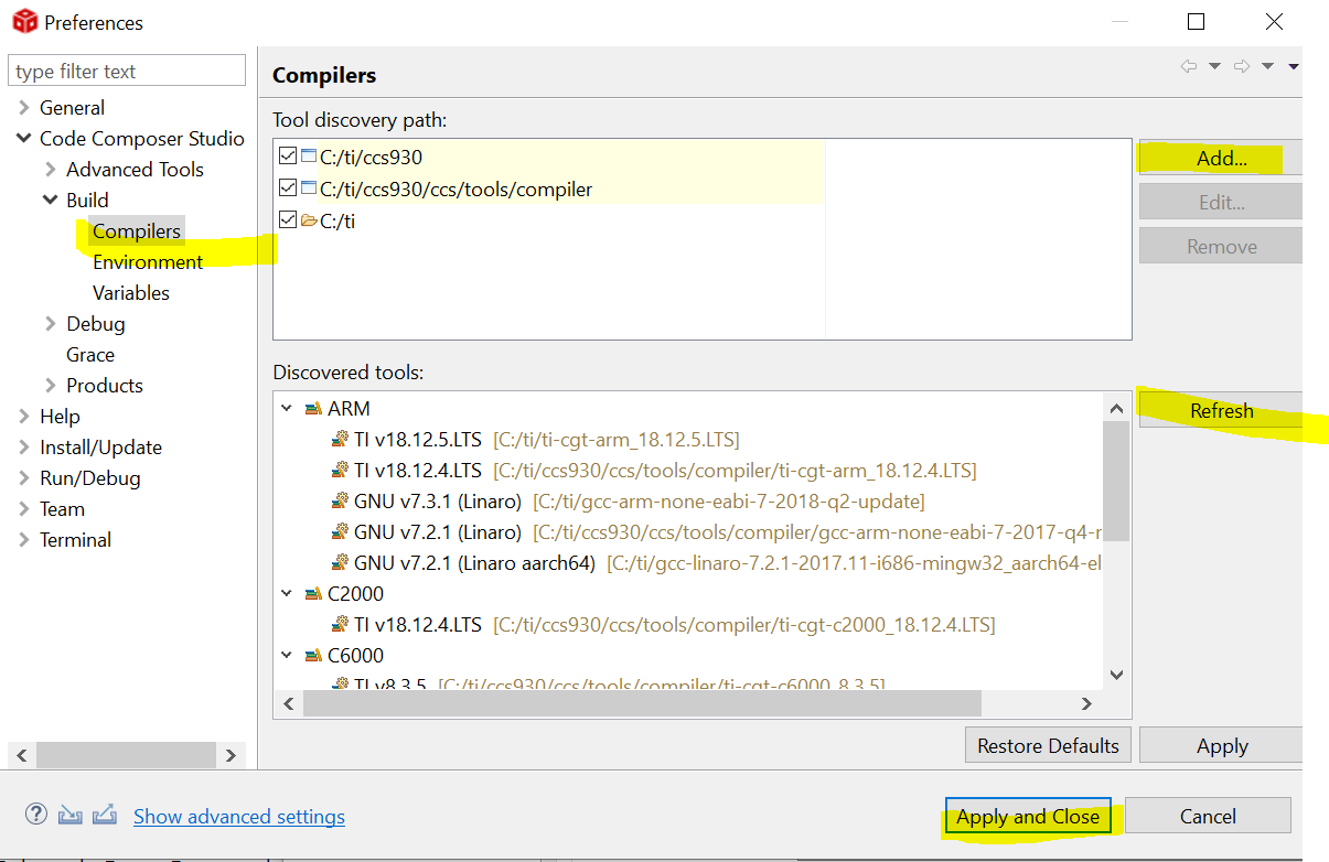

    Same thing for CGT 8.3.2 if not detected:
    Regards, Eric
  • Hi Eric(lding),
    Thanks. That helped!
    I can see the project folders in the created directory now!
