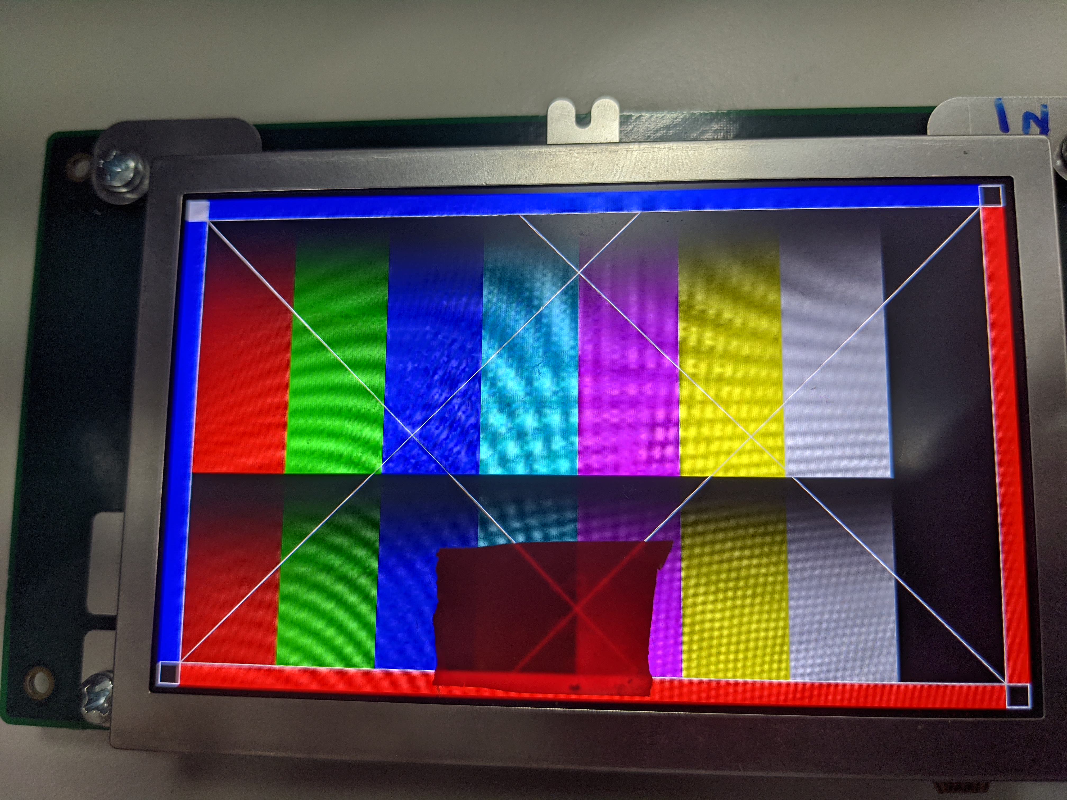

Hi all,
Board info:
AM3352
DDR3L 512M
NAND Flash 512MB
SDK05
Purpose: We want to use TI's root file system to test LCD screen changing continuously.
Problem:
root@am335x-evm:/usr/share/qt5/examples/opengl/textures# ./textures
Failed to create display (No such file or directory)
CCCCCCC

  • Hello Jason,
    Could you please share how you have setup your LCD in Linux? Also, please share the outcome of the modetest and kmstest commands.
    Krunal
  • Hi Krunal,
    After run kmstest
    Attached the dts & log

    root@am335x-evm:~# kmstest
    kmstest         kmstest.kms++   kmstest.libdrm
    Connector 0/@26: LVDS-1
      Crtc 0/@24 (plane 0/@23): 800x480 30.000 800/56/12/4 480/16/3/21 66 (66.16) 0xa 0x48
        Fb 30 800x480-XR24
    press enter to exit
    root@am335x-evm:~#
    Any idea about the fail "Failed to create display"? Or are there any testing can changing screen continuously?
