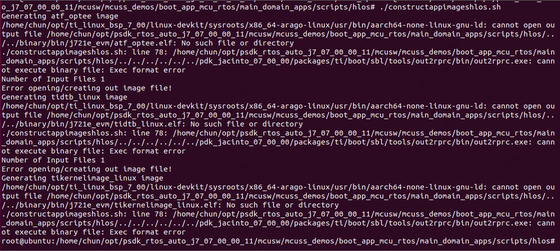

    1.According to the document description, we compiled the u-boot.img file in Linux, and then modified the constructappimageshlos.sh file according to the steps, and then ran the script on Linux, but it failed. The error message is as follows:
    Error messages:

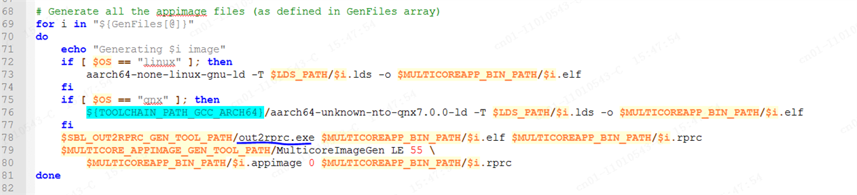

    2.Then we found a line of code in the constructappimageshlos.sh script that called the out2rprc.exe file according to the error message. As shown in the figure below, why would the exe file be called in the Linux script? Is this error preventing me from generating atf_optee.appimage/tidtb_linux.appimage/tikernelimage_linux.appimage?

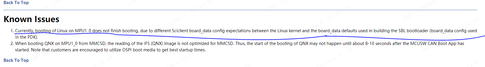

    3.I was looking at the index.html document in psdk_rtos_auto_j7_07_00_00_11 in mcusw/CAN Response and Bootloader Demo Application/Known Issues and found that SDK7.0 does not support MPU1_0 startup for some reasons (as shown in the figure below). How do we need to modify these configuration files? How to start MPU1_0 through R5?
    Can you tell us how to modify these Sciclient board_data config configurations so that we can use the Early Can startup scheme and start MPU1_0 in R5? Looking forward to your reply

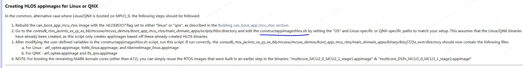

    3. According to the document description, we compiled the u-boot.img file in Linux, and then modified the constructappimageshlos.sh file according to the steps, and then ran the script on Linux, but it failed. The error message is as follows:
    TI>> See above, u-boot is not supported in SBL bootflow and you need to set your paths correctly (See answer below)
    4. Then we found a line of code in the constructappimageshlos.sh script that called the out2rprc.exe file according to the error message. As shown in the figure below, why would the exe file be called in the Linux script? Is this error preventing me from generating atf_optee.appimage/tidtb_linux.appimage/tikernelimage_linux.appimage?
    TI >> No, out2rprc.exe is correct, it's not a windows binary. Maybe your path is incorrect, you can find it under pdk/packages/ti/boot/sbl/tools
    5. Can you tell us how to modify these Sciclient board_data config configurations so that we can use the Early Can startup scheme and start MPU1_0 in R5? Looking forward to your reply.
    TI>> I will see if there is a plan to fix this.

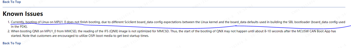

  • Hi Xie,
    I enquired further. SDK 6.02 had basic Linux boot support with CAN boot App because there were no resource conflicts, however certain peripherals were not supported.
    With 6.2 and 7.0, as more peripherals were added, that support was broken. This resource conflict issue will be fixed in 7.1 as SBL will support Linux booting. I suggest that you wait for it if not urgent.
