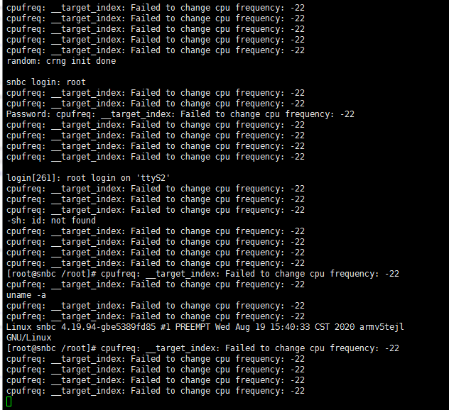

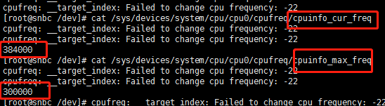

The lastest release(2013) Linux version is 2.6 in TI website, now we need to update linux kernel, the solution is using linux 4.19 which is from OMAPL138 Linux PSDK (ti-processor-sdk-linux-omapl138-lcdk-06.03.00.106 ), we finished some migration on dts file and remove DSP related node/configuration, rebuild the kernel, after download the kernel into our board, it shows:
cpufreq: __target_index: Failed to change cpu frequency: -22

When board start up and into uboot,download kernel , ramdisk and dtb into DDR by tftpboot command,and using bootm kernelAddr ramdiskAddr dtbAddr to start kernel,and kernel can start up and entry ramdisk, but it always show:
quary with command: cat /sys/devices/systrm/cpu/cpu0/cpufreq/
current running frequency (cpuinfo_cur_freq): 384MHZ
max support frequency (cpuinfo_max_freq ): 300MHZ
min support frequency ( cpuinfo_min_freq ):96MHZ
scaling_cur_freq: 96MHZ

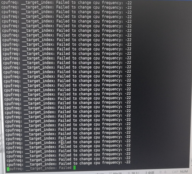

    a."# echo 384000 > /sys/devices/system/cpu/cpufreq/policy0/scaling_min_freq"
    ofcause, we changed the scaling_max_freq before set scaling_min_freq, and after set scaling_min_freq,The phenomenon is as follows
    It will loop out the print prompt,and stop after enter a command,we checked the frequency information:
    cpufreq max: 300000
    cpufreq min: 96000
    cpufreq cur: 384000
    scale max:300000
    scale min:300000
    scale cur:300000
    it looks wrong data.

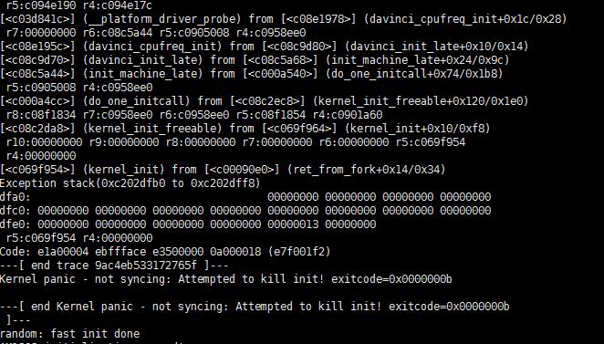

    b,u-boot> setenv maxcpuclk 456000000
    after enter u-boot and setenv maxcpuclk 456000000,then when use bootm command,it failed to load kernel (stop after init random )as follow:

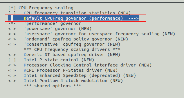

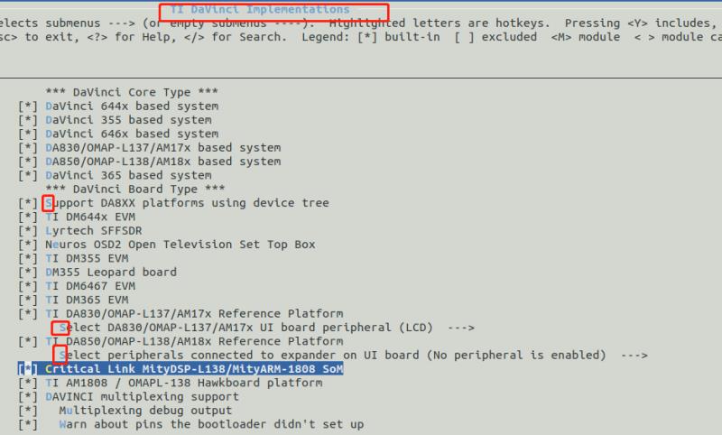

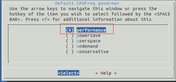

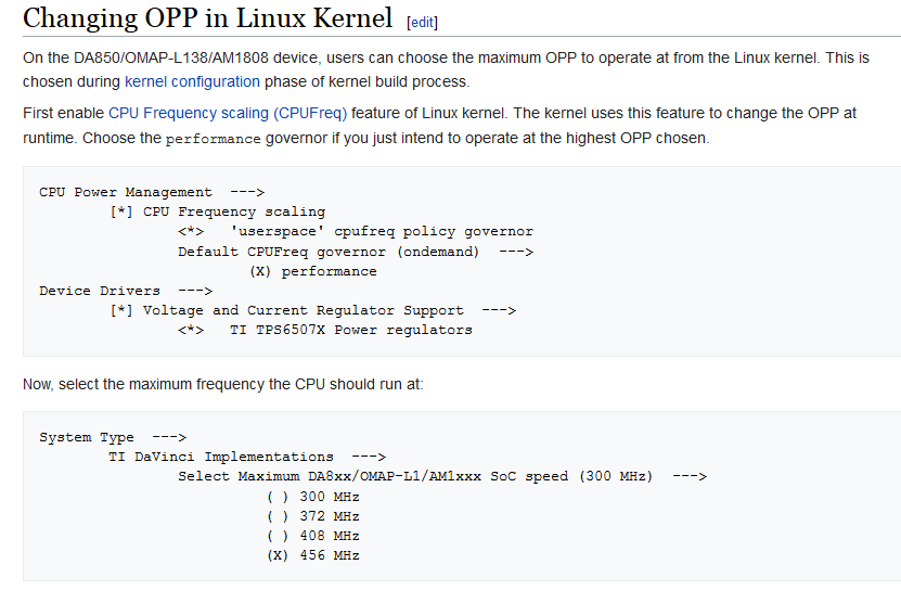

    c. choose the maximum OPP to operate at from the Linux kernel
    I just configure the kernel like this:
    but I cannot find Select Maximum option after second step( ti-processor-sdk-linux-omapl138-lcdk-06.03.00.106 SDK):
    Thanks very much.
