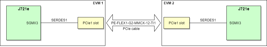

Is it possible to connect two DRA829 EVMs in MAC to MAC mode using SGMII connection?
  • Introduction
    On DRA829VXEVM the PCIe x2 lane slot can be used to connect two EVMs in SGMII MAC to MAC mode using a PCIe cable.
    This PCIe slot (PCIE1) is connected to SERDES1 instance.

    • Hardware
      • Two DRA829VXEVM
      • PCIe Cable - PE-FLEX1-G2-MMCX-12-TI1

    Changes for configuring MAC port 2 to SGMII and corresponding SERDES configuration
    EVM1: pdk/EVM1_SGMII_MAC_MAC_configuration.patch
    EVM2: pdk/EVM2_SGMII_MAC_MAC_configuration.patch
