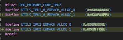

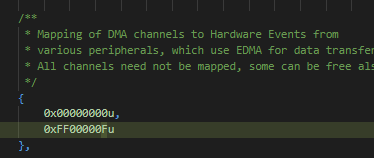

TDA2HG: MCSPI EDMA RX enable but RX FIFO still full
Part Number: TDA2HG
I need use MCSPI1 as edma slave mode. So I refer to "TDA2x TRM" chapter "24.3.4.8 DMA Requests", and set DMAR and DMAW bits 1. But RXFFF bit still set 1.
Is it  reasonable? Or what I missed?
I attached my MCSPI register below, would you please help me to check it? Thanks!

  • Tim,
    I noticed some irregularities in register fields related to IDLE mode.  From your table, I looked up the following register/value combination in the TRM:
    | 0x48098110    | 0x00000318 |
    See "Table 24-305 MCSPI_SYSCONFIG."  The register field SIDLEMODE has a reset value of 0x2.  It looks like you have it set to 0x3, which is a reserved value.  Are you unintentionally setting a a bit in this field somewhere?  If you change that and it doesn't fix the problem, you could try setting IDLEMODE field to 0x1, "No-Idle mode."  Currently, it is set to 0x3, which allows it to go into IDLE mode.  However, the ENAWAKEUP field is 0.  The WKEN field is also 0.  Both must be set to 1 in slave mode for the device to wake up when the CS goes active.
    -Zack
  • Hi Zack,
    Thanks for reply!
    I set SIDLEMODE as 0x2:

  • Hi Tim,
    I think EDMA channels are fixed for the McSPI driver and it is defined in pdk/packages/ti/csl/soc/Tda/cslr_soc_defines.h header file. Can you please sure that these channels are reserved in the core from where you are accessing McSPI?
    I think in vision sdk, EDMA channels are reserved in the folder \vision_sdk\links_fw\src\rtos\utils_common\src\dma_cfg. There is header files for EDMA channels allocation for each core.
    Rgds,
    Brijesh
  • Hi Brijesh,
    Thanks for your reply!
    I edit p/links_fw/src/rtos/utils_common/src/dma_cfg/utils_dma_cfg_sys_edma_tda2xx.c before:
    And from log IPU2 use channel 40 and 41:
    And IPU1 MCSPI use channel 35 and 34. So I think it should no conflict.
    The weird thing is even I disable 40 and 41 channel in IPU2 MCSPI just goes better, but still have some wrong complete and error interrupt.
    Thanks!
