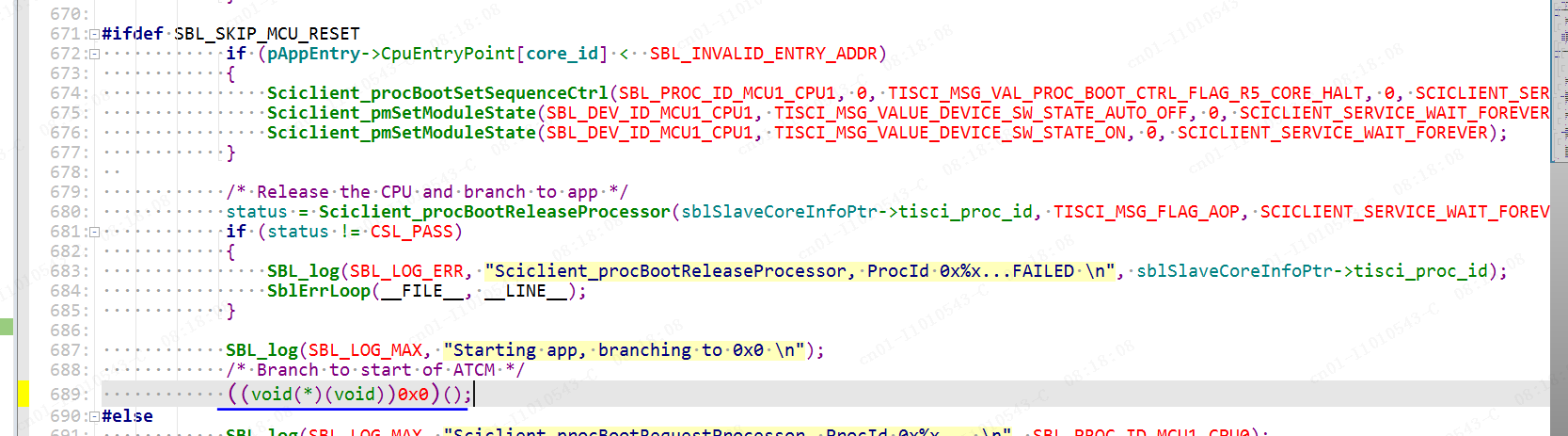

    When I saw the last jump in the SBL_main.c file, I jumped to 0x0 through MCU1_CPU1,as shown below:Why not through MCU1_CPU0?
    Then how does the multi-core core get instructions from Nor flash through an OSPI to run? How to avoid hardware resource conflicts caused by simultaneous access of multiple cores?
    Xie
  • Hi Xie,
    There are some discussions happening internally. I will summarize them once we have more clarity. Meanwhile you can ask for the current status from Fan Zhang.
