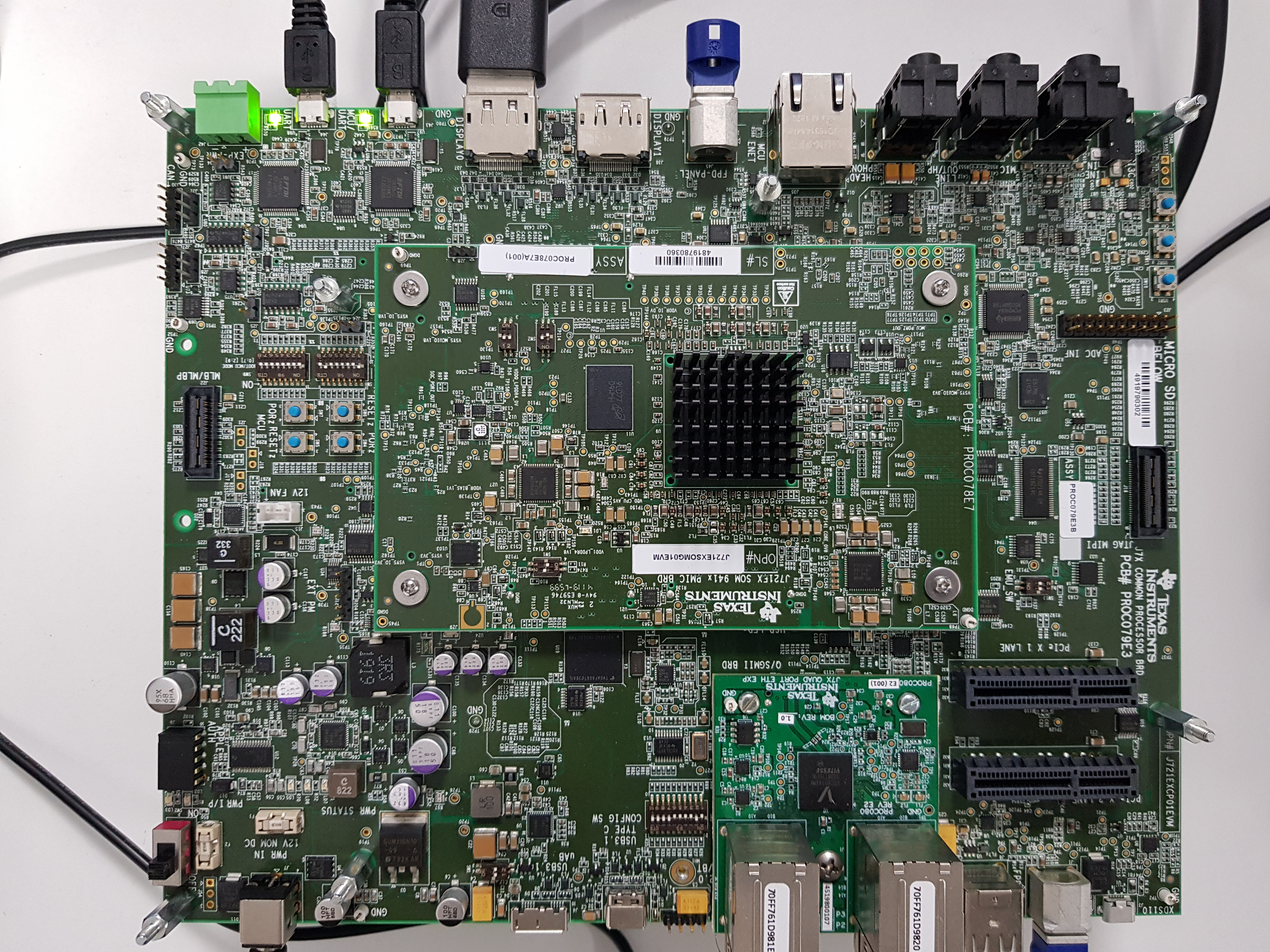

             I success to build the vision_apps and to execute the command(make qnx_fs_create_sd, make qnx_fs_install_sd),
            but when I run on EVM, nothing print on the uart terminal. (I execute all terminal : ttyusb0~5)

  • Hi kb
    Always thanks you reply.
    I execute your reply(Coy the sysfw-psdkra.itb th the sysfw.itb and run to evm), nothing still print on the uart terminal.
    Previously, I already executed the linux(Based on Argo project and Yocto)+RTOS mode on this EVM board, I think the EVM HW setup is not problems.
    Just in case,  I attch error log, board environment picture and Uart terminal results.
    Full_Execution_error_log(SDK7.0_Build_setup_Build_Run).txt
    And I upload the SDK7.1 error log below, let me know what the problem is.
    Full_compile_error_log(SDK7.1_make qnx_fs_create_sd).txt
    Please review two problems and reply the solutions.
    Thank you.
    Regards kb
  • Thanks KeeBeom,
    If the board boots for Linux SD boot, there is no difference for QNX SD boot, so H/W can be ruled out.
    Regarding the 7.1 build issue, please make the below modifications, and try the build steps again.  Looks like the build script is attempting to copy files that do not exist in the installation environment.

  • Hi KeeBeom,
    Regarding the SDK 7.0 not showing output on terminal window,  you could try the below to see if it helps:
    1) The sysfw.itb may have been over written incorrectly by the scripts.  Try downloading prebuilt boot images from below link:
    https://software-dl.ti.com/jacinto7/esd/processor-sdk-linux-jacinto7/07_00_01_01/exports/boot-j7-evm.tar.gz
    Copy the sysfw-psdkra.itb file from the zip to the root of the SD card you are testing, as sysfw.itb
      cp sysfw-psdkra.itb.fromzipfile  /media/$USERNAME/boot/sysfw.itb
    Try and boot, and see if anything shows up on the prompt.
    2) Try powering off board, shutting down the terminal window, unplugging cable, then plugging in cable, restarting terminal window and then powering board back on.
    Regarding the SDK 7.1, will respond today with suggested steps.
