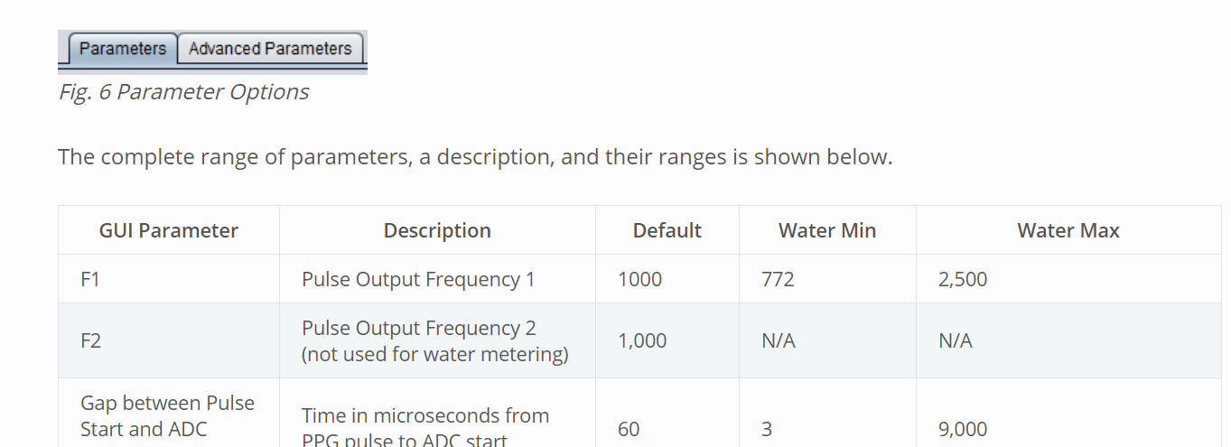

  • Hi Koki,
    For the transmit frequency, Water meter just support minimum 772Khz:
    Why do you need set this para to 230KHz?
    Thanks!
    Best Regards
    Johnson
  • Hi,Johnson
    Due to the operating environment, it is necessary to verify the operation around 230kHz.
    And I know that it is feasible from past E2E posts, and I am working on it.
    https://e2e.ti.com/support/microcontrollers/msp430/f/166/p/794211/2938341
    Q1. Why does the error in the first post occur?
    Do you have any countermeasures?
    Q.2 Why do the following two errors occur ?
    136 Algorithm DToF - Correlation overrun error
    137 Algorithm DToF - Correlation interpolation error
