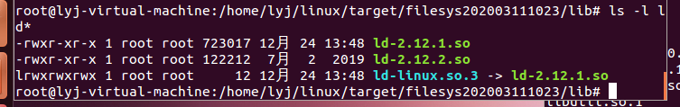

Customer used dm8148. The rdk package is ipnc_3.8. However, the related dynamic libraries in the cross-compilation chain in the package and the lib libraries in the folder of the file system in the package all have no symbol table.  It is impossible to debug segmentation errors and bus errors. He downloaded, compiled and transplanted the 2.12.1 version of glibc, but it still doesn’t work. Do you have the following dynamic library with symbol table?

    The customer uses the file system packaged by the folder (filesys) in the rdk_3.8 package and downloads it to dm8148. The .so dynamic libraries in its /lib directory are all without symbol table. During gdb debugging, if the standard C library function called by the program is provided by the dynamic library, then the error message of gdb debugging does not display the function name.
    For example?? (), if the dynamic library has a symbol table, when gdb is debugging, the wrong part is with the function name. EG: memcpy()。
    The problem that the customer encounters is that when gdb debugs, it is always? ? (), unable to find the place where the program crashed (segment fault or bus error)
