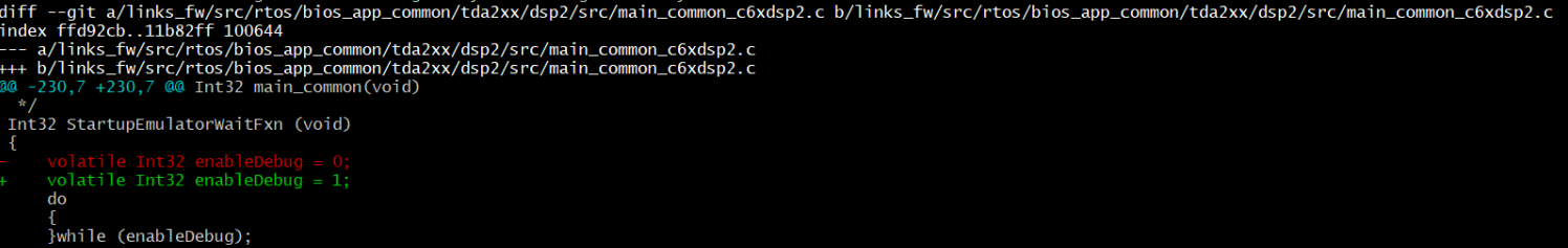

    The above logs clearly tell there is illegal memory access in the DSP core so you should use JTAG to debug where it's happening the memory corruption.
    To use the JTAG debugger build the code in debug mode before that add the below changes in the code.
    You just need to set the variable "enableDebug" = 1;
    The above changes given for the DSP2 core & you should do the same changes for the other core if you want to debug MMU-FAULT in the other core.
    Connect the JTAG debugger then set the variable value "enableDebug = 0" in the CCS expression window then start debug by putting break-point & find out the issue.
