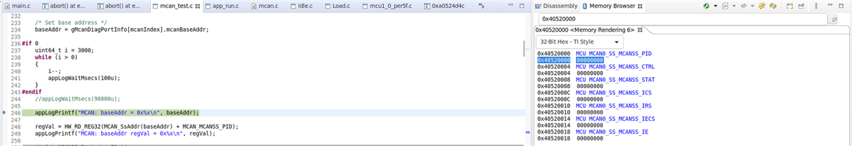

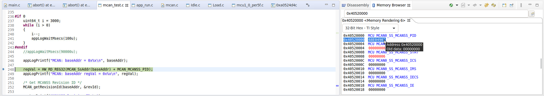

1. I use CCS debugging to find that the program can run at present, but when reading or writing registers, the program will terminate directly.
For example, in mcan_test.c:: MCAN_getRevisionId(baseAddr, &revId), the baseAddr is 0x40500000, when it calls HW_RD_REG32(), it will terminate at
static inline uint32_t HW_RD_REG32_RAW(uint32_t addr)
    uint32_t regVal = *(volatile uint32_t *) ((uintptr_t) addr);
    /* Donot call any functions after this. If required implement as macros */
    HW_SYNC_BARRIER();
    return (regVal);

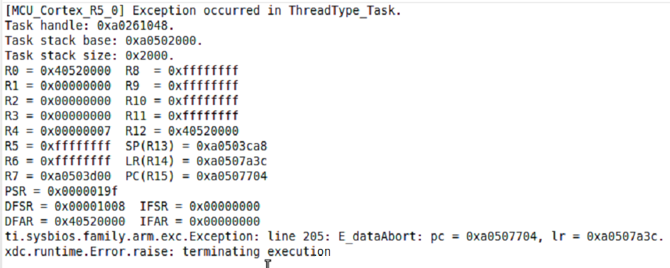

This is the printed message of CCS at termination.
2. Occasionally, the register can be read and written successfully, and the program can run normally (only under CCS debugging). But most of the time, the program will report an error. Without CCS the program was never started successfully.
How to read and write register successfully?

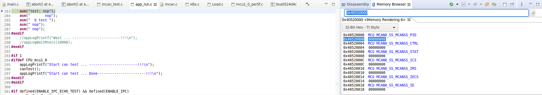

    Your exception show that DFAR (Data Fault address register) is 0x40520000.
    Can you please tell me what code is executed as a part of canTest()? Also how are you loading the application? Are you modifying an already existing firmware and that gets loaded by SPL/u-boot/kernel and then you connect to CCS?
    When connected to CCS, from the memory browser, can you view the memory at 0x40520000? If not then it could be possible that the module is turned off.
    Karan

    3. After my further test, I see the value of 0x40520000 and other register about MCAN0 and MCAN1 is always 0 after the mcu1_0 start up.
    I found that before reading the register, the value of MCAN0 is still 0.
    I need to wait for 30s to 2min, then 0x40520000 will get right value. If the register have value, the code runs well.
    Why is this? Should I wait for some time after mcanEnable() ?
    I tried to add appLogWait() to wait for some time but is didn't work. Should I use other method to create delay?

  • Hi JJXie,
    The issue here is that somehow your MCAN module is not getting initialized - this is when you don't see correct value in the PID register.
    Now as soon as your MCAN gets initialized (PID register shows the correct value) then you transmission happens properly.
    The reason could be that the MCU1_0 firmware is being loaded before your bootloader is initializing the MCAN module.
    A simples test would be to add a delay (as you have tried) - use the appLoadWaitMsec() to add delay.
    Another test could be to add a while() loop below the canTest() and then connect the debugger to get out of that loop. When stuck in the while look - check the value of PID register from the debugger.
    # Add a volatile global loop variable
    volatile uint32_t loopVar = 0xDEADBEEF;
    # Just before the canTest() add the below
    while(loopVar)
    # Connect debugger and load symbols. From the expressions tab - change value of loopVar to 0 and execute.
    # Also check the PID register at this moment.
    Karan
