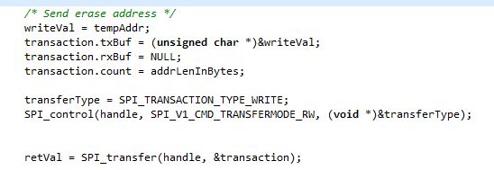

When I look at the function called S25FLFlash_BlockErase, I see that there is a byte swap of the address value taking place in the code, I highlight that code in a red rectangle:
Later on that byte-swapped tempAddr variable is being transmitted:

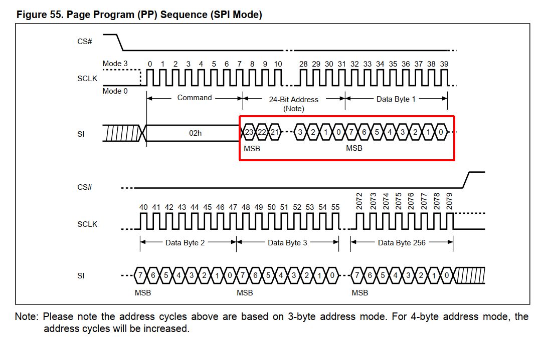

This might be a required action, since the highest address byte information has to be placed first on the SPI bus, see here from the Macronix MX66L51235F datasheet the block erase instruction:
But for all flash transactions the most significant byte has to be sent first. Here a screenshot of the page program sequence  out of the Macronix datasheet, which the example project uses:

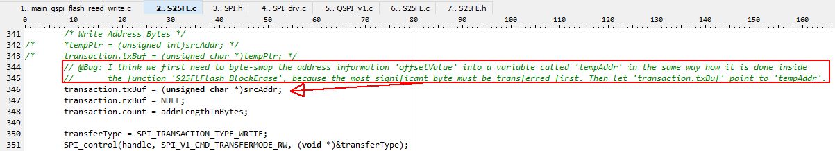

But when I now look inside the function SF25FL_ConfigMode_Write, which is called by SF25FL_bufferWrite, then I don’t find any byte swap of the address, the transaction.txBuf pointer points to a non-swapped variable. See here a comment that I added in the red rectangle:

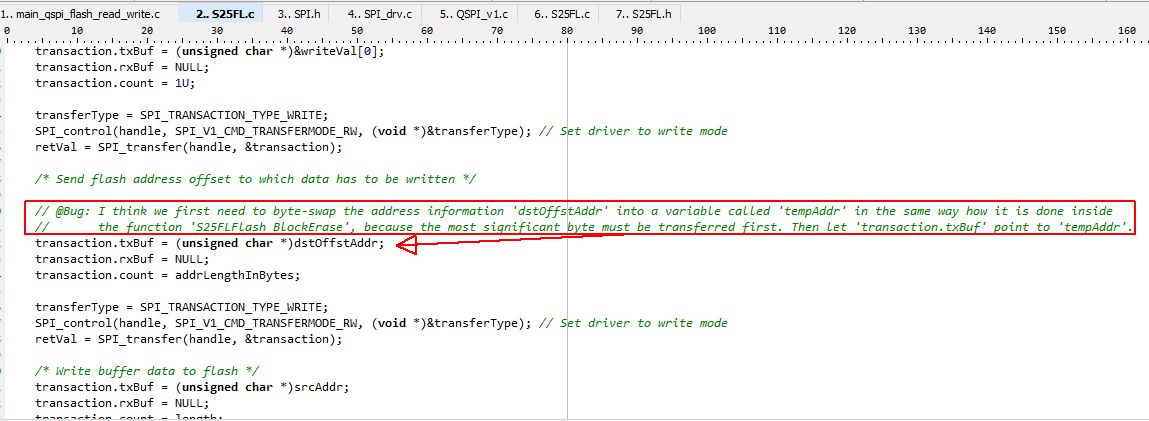

And the same might be valid also for the SF25FL_bufferRead function:
Can you please check if this is correct?
