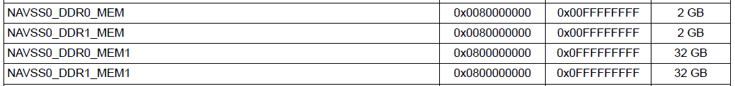

Access to DDR memory is limited by 2GB.
We want to be able to access 32GB area for this.
Please let me know how to do this.
■Remarks
\ti\ccs1011\ccs\ccs_base\emulation\gel\J721E_DRA829_TDA4VM\gel\J721E_DDR32SS
The file above only supports 32 bits.
 →Requires a 64bit-compatible gel file.
Currently, NAVSS0_DDR1_MEM is used in the GEL file, but please provide a GEL file to use a 32GB map.
    If you have a 4GB DRAM, you can access the upper 2GB memory at 0x880000000 - 0x8FFFFFFFF.

    I'm very sorry, but I'd like to know how to access there from C7x.
    We have prepared an evidence for this case, please examine it.
    We are in a situation where we are unable to access a possible area.
    In the table below, we are trying to use the range 0x08 00000000 - 0x0F FFFFFFFFFFFF in the bottom two groups.
    We'll call them 64-bit addresses.
    UTLB is not initially mapped to a 64-bit address.
    Therefore, the MMU needs to be configured, but even if it is configured, it will not work correctly.
    Page Fault exception occurs when attempting to read.
    Our prediction: DDR initialization in launch.js does not support 64bit addresses.

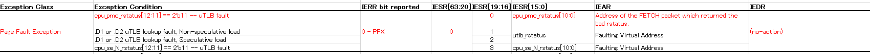

    ■Test case
    c7x_mmu_0208.zip
    The above environment is for the MMU sample program, with a section for 64-bit addresses added.
    The TCR register have been changed to the latest recommended values.
    The DSP execution freezes when the sample program is executed.
    From the following register results, it can be confirmed that a Page Fault exception has occurred.
    As I previously stated, you should be able to access the upper 2GB memory at 0x880000000 - 0x8FFFFFFFF. I do not think the range you have mentioned above is valid.
    pbyPtr = (uint8_t*)0x0800000000ULL;       <-- Not valid
    assert(1 == *pbyPtr); // Page Fault
  • HaTa,
    I confirmed with the design team that the SOC address space 0x800000000 - 0x87FFFFFFF is permanently disabled on TDA4VM.
    Thus as previously mentioned, you need to use 0x880000000 - 0x8FFFFFFFF.
