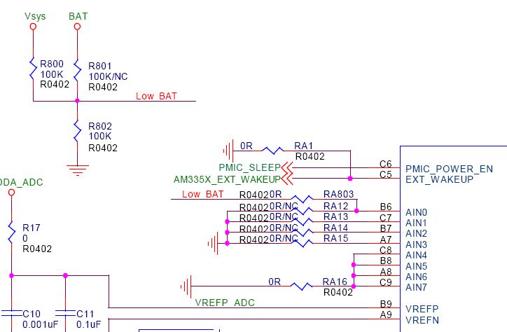

We are using am335x evm in our custom board and we are using
linux-3.2.0-psp04.06.00.08.sdk
 source code in our board.we have APDS-9007 ambient light sensor connected as input to the ADC AIN0 pin on processor. we want to use pin AIN0 of am335x inbuilt adc on am335x.we downloaded the ti_adc driver from arago-project in our kernel source code.we made the neccessary changes in our kernel board file using the guide http://processors.wiki.ti.com/index.php/AM335x_ADC_Driver%27s_Guide.
the folder /sys/bus/iio/devices/ not showing any devices in our filesystem ,i had compile my ti_adc as kernel inbuilt driver and also tried using ti_adc as module.
following are the board file changes  in arch/arm/mach-omap2/board-am335xevm.c
static struct adc_data am335x_adc_data = {
.adc_channels = 1,
static struct mfd_tscadc_board tscadc = {
.adc_init = &am335x_adc_data,
static struct pinmux_config adc_pin_mux[] = {
{"ain0.ain0", OMAP_MUX_MODE0 | AM33XX_INPUT_EN},
{"ain2.ain2", OMAP_MUX_MODE0 | AM33XX_INPUT_EN},
{"vrefp.vrefp", OMAP_MUX_MODE0 | AM33XX_INPUT_EN},
{"vrefn.vrefn", OMAP_MUX_MODE0 | AM33XX_INPUT_EN},
{NULL, 0},

  • Hi Pavan,
    Raw ADC is not supported in your version of the SDK/PSP (info). It is supported in the next version of the SDK/PSP.
    Miroslav

  • Hi Pavan,
    There seems to either be a bug with the ADC driver, or an incorrect wiki description. You shouldn't completely disable the TSC. Please try the following board file configuration:
    static struct tsc_data am335x_touchscreen_data  = {
        .wires  = 0,
        .x_plate_resistance = 200,
        .steps_to_configure = 5,
        .adc_channels = 8,
        .tsc_init = &am335x_touchscreen_data,
    I'm simply setting the tsc_init.wires element to 0 rather than commenting out the whole structure. Otherwise this element of the structure is not initialized, so the kernel crashes when trying to dereference a pointer to it.
    When I do this, the kernel starts normally and then when I insmod the ti_adc.ko kernel module everything works OK:

  • Pavan,
    I  got the output  as you posted.
    but why can't  show 'mode' as below:
    -rw-r--r--    1 root     root         4096 Jan  1 00:00 mode
    and I can't  read a single ADC output, why?
    root@am335x-evm:~# cat /sys/bus/iio/devices/iio\:device0/in_voltage0_raw
    0
    thanks!

  • Miroslav,
    I always get  the value ' 0 '.    I don't use the patches.
    my schematics is as below, thanks.
