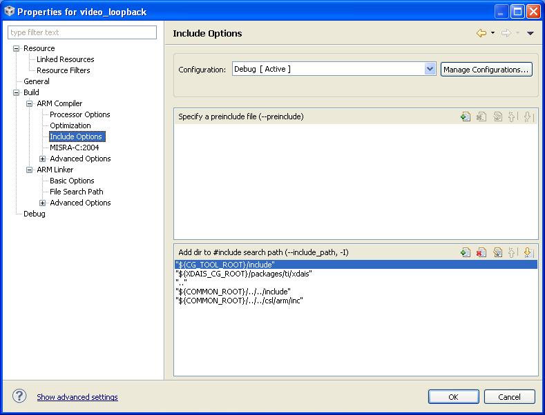

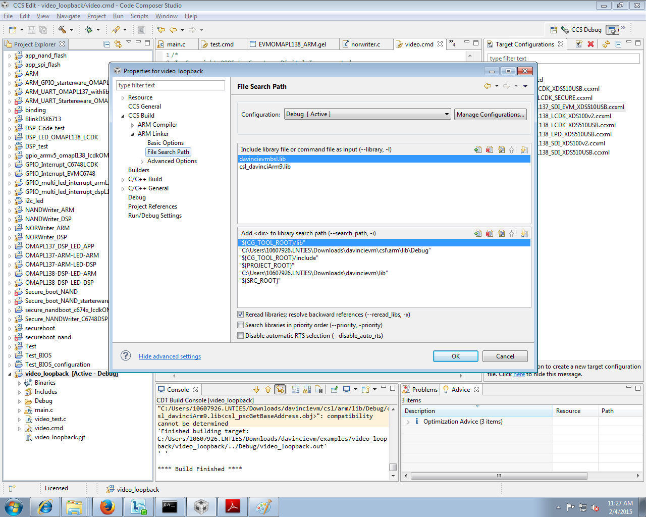

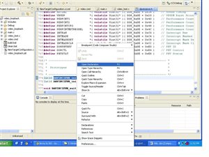

Code composer studio v 5.5.0 files inclusion
I am trying to download and debug sample video applications on Spectrum Digital davinci EVM6446 and trying a sample video loopback code given by spectrum digital(importing ccs 3 codes). when I include some c files and header files in the code, the functions are not getting linked and also I am confused with how to include the files(file path) gone through   link too. but still the same problem, can anyone suggest proper inclusion and execution of the application
tools:
CCS : Code Composer Studio 5.5.0 (for Windows XP PC)
Emulator: spectrum Digital XDS560v2 LC traveler Emulator

    4) I'm getting library linker error that library not found.
    5) I've commented out the library entry in video.cmd file.
    video.cmd
    //-l..\..\csl\arm\lib\Debug\csl_davinciArm9.lib
    //-l..\..\lib\davincievmbsl.lib
    6) Then I've added the library name and its path in  CCS properties.
    CCS properties -> CCS Build -> ARM Linker -> File search path
    Please refer to the attached screen shot.
    C:\Users\10607926.LNTIES\Downloads\davincievm\lib
    C:\Users\10607926.LNTIES\Downloads\davincievm\csl\arm\lib\Debug
    davincievmbsl.lib
    csl_davinciArm9.lib
    Now, I'm able to build the video loopback example. You have to do the same step for all examples given.
    Please let me know the results.
    instead of comenting
    paths you can give your absolute path or relative path of the said .lib files in your pC(these files also available in davincievm folder you have downloaded : "davincievmbsl.lib" is in \davincievm\davincievm\lib and "csl_davinciArm9.lib "will be in : davincievm\davincievm\csl\arm\lib\Debug folders)
    Here I am not getting the errors. I am able to compile the code But even if I have included the files in the project settings I am not able to open a particular function by right clicking on function name and selecting " open declaration"(refer attached screenshot :file1") later I have tried this ( www.argenox.com/.../making-code-composer-studio-projects-portable) suggestions and my files are getting linked.
    My doubt here is if I creat a new project having some files where all i have to mention the inclusion of the file in project setting? In project setting CCS has options like Linked resources, include options, file search path( right click on project name in the project explorer and select settings). which is the proper way to include, and which is for what?
    Venkat
  • Please find the attachments
    file 1: function link
    file 2:  for project setting
  • Use "copy" option when you create a new CCS project for new "*.c" "*.h" file.
    Link option is some what confuse for newbie.
    Just you can copy the selected file from one CCS project and paste to some other CCS project.
    Able to build successfully the CCS project and executable ?
