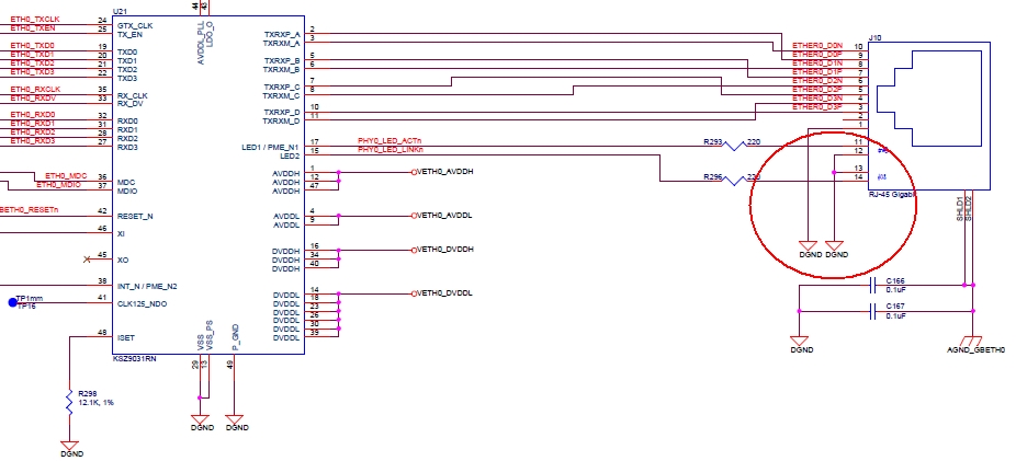

It seems that the LED polarity of the Gigabit Ethernet Link and Activity LED might be wrong on the AM571x IDK EVM (J12, U24 and J10, U21). KSZ9031RNX turns-on the LED's with a logic "L". I could not find a register in the PHY that can change polarity of the LED's.

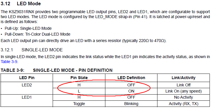

    The IDK is correct. This PHY has two modes for the LED pins. See the KSZ9031RN datasheet for details.

    True that there are two LED modes. But that in my opinion does not change the polarity of the LED. LED Definition "On" is always with a logic low level. That means the LED should have been tied to VETH0_DVDDH instead of DGND. I'm quite shure that the LED's are on after power up even without a valid link. Bur maybe I have overseen a setting that can change polarity.
    Concerning the LED_MODE: Maybe there is also missing a Pull-Up or Pull-Down resistor on Pin 41 to set either Single-LED mode or Tri-color dual-LED mode. I have not seen a default strap when no resistor is used.

    No, I'm talking about the Gigabit Ethernet LED's around U21 and U24. In my opinion the following does not match:
    Patrick
  • Patrick,
    I agree with your assessment.  Pin 41 should have a pull-up resistor attached and the LEDs should be properly connected with the anodes to VCC so that they turn on when the status output pin goes low as shown in the table.  We will add this to the documentation.
